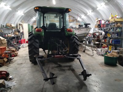

Mine has been living in the shop for right now. Been putting a magnetic heater on the oil pan last couple of days. When I first got it I fought it gelling constantly from the junk diesel the dealer put in it. We had no degrees today, 0°, and no problems firing up and feeding.

My tractor started right up today. Kubota FTW.
I need one of those magnetic heaters.
Why do you not put it next to a coolant jacket on the block?

Need the oil flowing for lubrication over the need for warm coolant. Oil pan is stamped steel so it will not transfer the heat from a coolant heater very well. It is not as efficient running when cold and warming up I understand. I will at some point pick up a coolant heater kit for it so I can warm both on a timer. A hydraulic fluid heater would be helpful as well considering how much on this tractor runs on it. Current price for DZ102076 heater kit is $154 from dear john.
