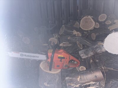

Was pretty surprised yesterday afternoon when I was thinking about my old 075 i thought I popped several years ago and figured I’d pull down and repair it. Well seemed to have lost compression that day and died while I was running it so I just assumed. Pulled off shelf after probably 6 years and pulled rope seemed to have decent compression bore scoped or and looked ok. Stuck gauge in 140 psi still drink of gas down carb 2-3 pulls runs great still. No idea if rings stuck or what happened but it seems all good now. Really like it when they fix themselves makes it much faster.
