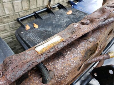

Anyways... rear suspension is out of the grandpa Buick. It was very... patina'd. You can see in the top pic where it crushed when I started lifting it with the floor jack.

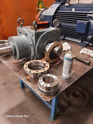

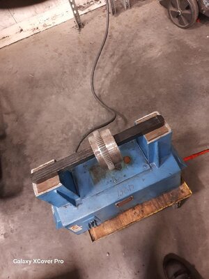

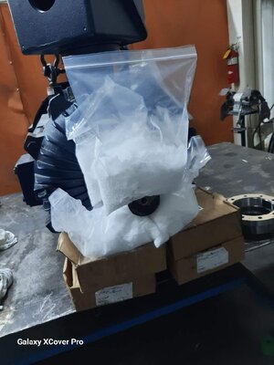

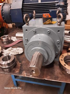

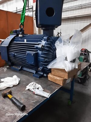

Got to have a little fun today and sweat some couplings on for a shutdown job we are doing over Christmas.
150 HP hoist motor with brake and dual encoders(for position/over-run control).
The gearbox is a 1:1 power divider that feeds two right angle planetary gearboxes that drive the dual hoist drums on a 150 ton hoist. Its a ring-and-pinion gearbox.
Couplings are .002" interference fit. Thats all that holds them in place, but better than compression couplings etc if done right. That means the hubs are .002" smaller than the shafts they are to be mounted on.
Use dry ice to cool and shrink the shafts, and heat the hubs on an induction heater to around 325°F. Slide right on there.
This is one case where a BFH does you no good.
Have to use science and maffs n stuffs.😁
You chose these words very carefully didn’t you? Something like “you can see in the top pic where it crushed from jacking it” would’ve caught some attention.

We did inner races on 6" corrugator roll journals with .006" undersize on the races. They figured .001" per inch of shaft diameter, so your numbers sound right. Ours were heated in an oil bath to 600'F, you only had one shot and the journal was 27" long and stepped. Out of the 6 races we did, only had to cut one off and retry with a new one. Then we cleaned as the Dupont Crytox grease could not get any contamination from the oil.
I don't miss corrugators.

Love the induction heater Brent. Fast, efficient. and no flame. We use them alot in our trade too. Best thing since sliced bread. Thx for posting blue collar Georgia man. Not too offensive was it??
Just went by the OEM specs.
The gearbox couplings are metric. 75mm with N7? Fit spec.
Thankfully, this customer has a 72 year old machinist that does their critical work. He is top notch. Dont know what they will do when he goes home.
Found that the dry ice helps a lot. Had a lot of folks talk against it, but to me its simply math. If cooling the shaft buys you another .001", then the temperature difference is a moot point. Actually helps keep the sleeves and their o rings from getting too hot before I can get some wet rags going to bring the temp down slowly.

Here's an old man trick if you don't have liquid nitrogen. Go to Walmart and buy all the isopropyl alcohol you can carry. Add it to the dry ice and it will get colder.
