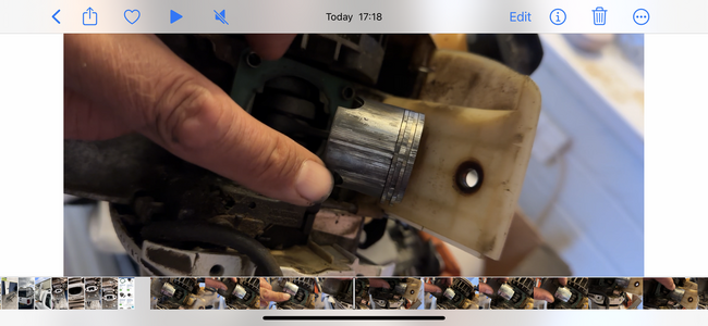

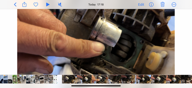

Then on the way home someone I know, I popped in for a coffee, they said there fs350 don’t work, it cutout cos it overheated 🤔
One looky at the piston says otherwise 🧐
Now it’s in my hands to fix it 😴
So what’s you guys thinking . ? Wrong mix ? Or 4corner seizure or both.. ..?
If piston is scored all the way around then it was straight gassed
If only in certain corners then you have another issue
But being a concrete saw I’d say doesn’t matter
The grit is all through the motor
first time reading i thought it said ts and not fs which is brush cutter and most shops dont deal with anything bigger than the 240/250 ones
on the intake side it does have wear but other corner is wet so im doubting straight gas so you may need to look at seals and hoses also
