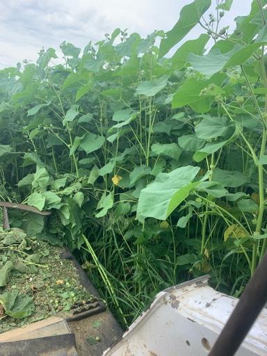

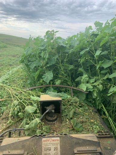

Sure hope you got a batwing hog for that Bobcat Mark. That sure is a bunch of traveling for a 72" hog.
Yes it is but there are trees in it so nobody else wants to do it
I told him $125/hr and he said that was fine do it
