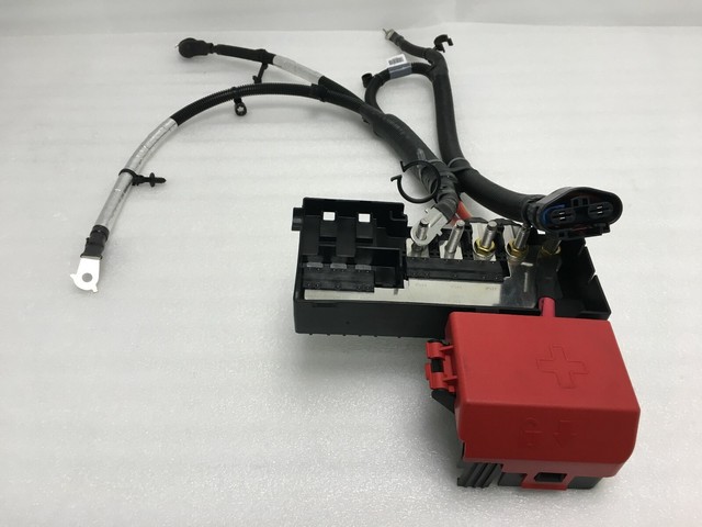

If i'm remembering correctly, that model should have that bus bar type thing on top of the battery that acts as like a distributer block. My Silverado has a similar setup and kept going dead at random times. Finally s**t canned the battery. On installation of the new battery, I found some funky corrosion and a few loose wires and such in that little box thing that was causing bad connection to certain lead wires to accessories and such. I think it stem's from the guys that installed my speakers. Cleaned it all up, tightened all the wire down, little dielectric grease, and a new battery and she hasn't skipped a beat
