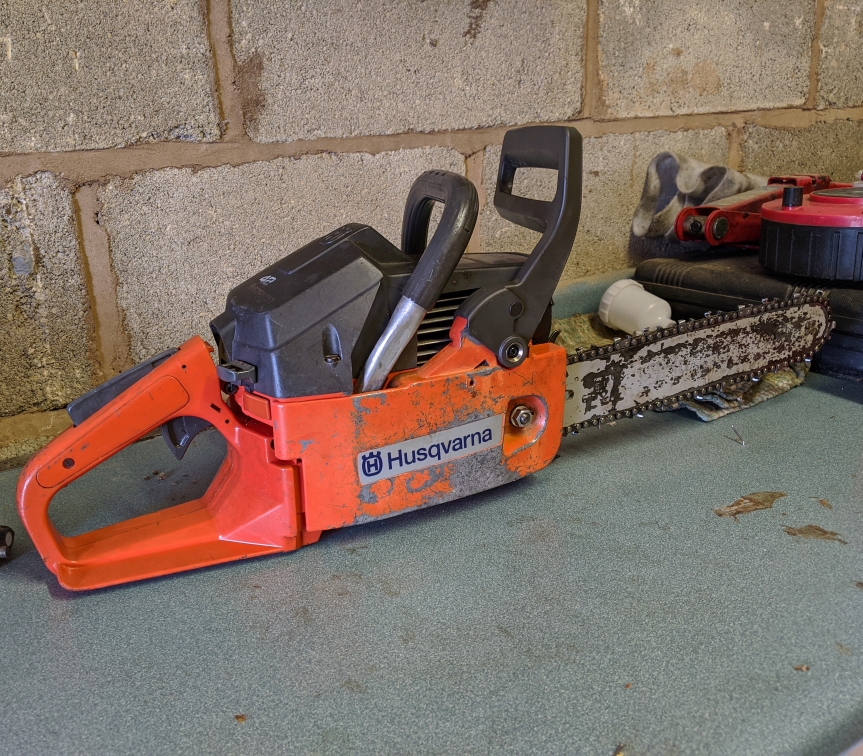

Damn. Well I don’t think it’s the pin causing me issues. It looks like the rollers on the bearing are worn on the sides. So the upper bearing has the same sort of properties as the big end crank bearing, no play up and down but play side to side. So weirdly it’s kinda kicking the piston round the bearing a tad when you rotate at tdc and bdc. I think a new bearing will sort it.

We have life in the 42. All back together. Sounds ace for 42cc. It idles revs and come back down nicely. Carb kit did the trick. I think there is a flat spot on a bearing somewhere probably from years of sitting doing nothing. Hadn’t managed to figure out which bearing. Ruled out the small end as it’s new. Can you even get the pto crank bearing? Are there even cranks around if it turns out to be the big end? It’s not too bad atm I can just hear the slightest on rotation of the crank. Can’t feel a thing though.

From memory as its been a yr or two....No in general ..... to most of what you asked , unless its on a shelf somewhere as old stock.
This group of saws is "Mostly" going to come down to using scrounged spares and spares from other saws.

I would double check with @Tor R but I believe it was the Stihl 020 AV PTO bearing that will work?
As in a ms200 series? They are roller bearings if I remember not the usual ball bearings? What do you do about the integral seal that you get on the 42? Something is still knocking on the 42, it runs amazing with a 13" bar the ok though. I think it may be piston slap at BDC and tbc. I need to look into it more. Apart from that it runs ace. I cut a 1 tonne builders bag quantity of apple yesterday around 4" max and it was as fast as anything in that sized wood.

Cleaned it and put a new spring on the chain brake. It's definitely not the pto or flywheel bearings. No play on those. I think it's definitely piston slap.

I have been tempted to get a 13 to try, Dad told me he had tried them but found the 15 worked better for him.
I just got the heated handles working on his 242 last night, now I need to figure out why it won't rev past 12.4K.
As for your knock, how did your piston skirts look? I have ran into a few worn intake side skirts that were still nice and smooth, but significantly thinner than the exhaust side. One 026 was so worn the piston was rocking enough at TDC to hit the squish band...
