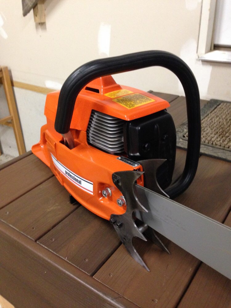

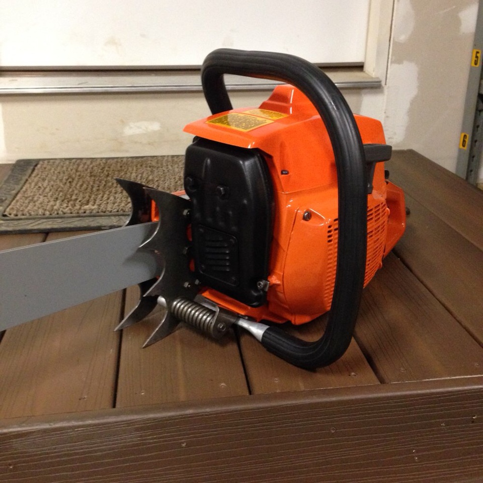

@Redfins build http://opeforum.com/threads/2100-resto.5769/page-10
It was a Beauty !!!
I had saved for inspiration, found out I’m way better at taking things apart though

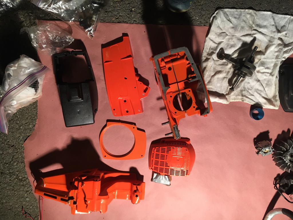

You could have it all powder coated, just need to find good plastics.
When I port them I use a 395 piston and a wj-70 carb. I can make it fit with the stock filter or a v-stack on a 288 low top filter neck.

I built my other 2100 that you ran with the 395 piston. This one is completely stock thin ring. Since building it I have found a few more nos bits to put on it.
Intake block, block grommet, carb adjuster grommet and correct starter handle. When these parts go on I plan on blasting the dogs and spring and gun blueing those parts.
I like that approach. I may travel two paths, build a decent runner while I also stockpile really nice parts for a restoration kinda like Bob mentioned. And always keep my eye out.
