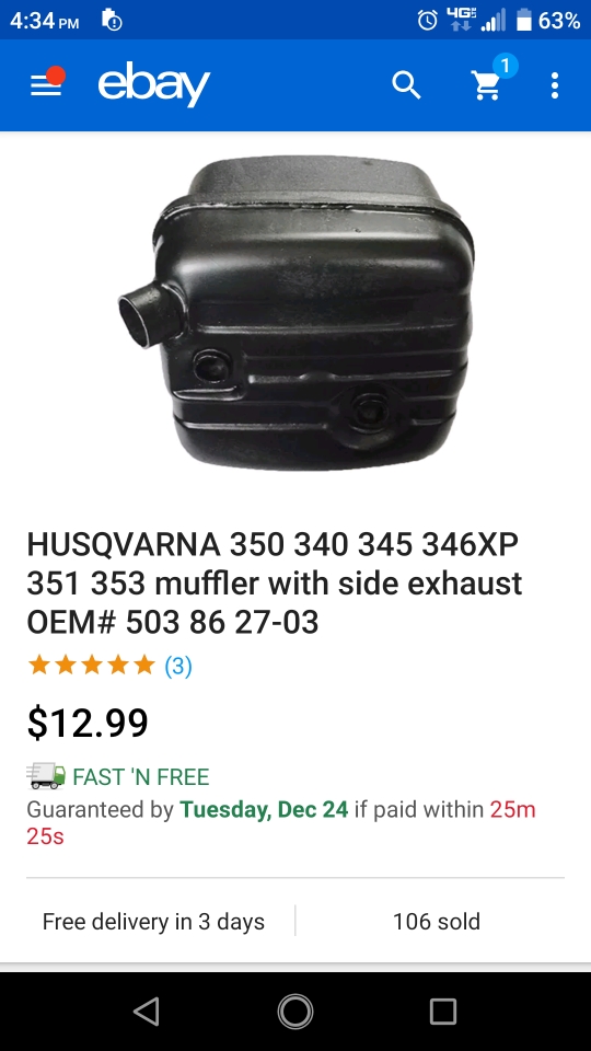

Just out of curiosity would a base gasket delete and muffler mod gain me anything over stock?
Will raise your comp 15 lbs. or more. Muff mod is a must.
WillG
11:18 PM
10686
Oct 10, 2019
1,730
9,060
Norwich CT
Awesome! Definitely going with gasket delete. Was browsing on eBay and found this! Looks like it might be an improvement over stock.
