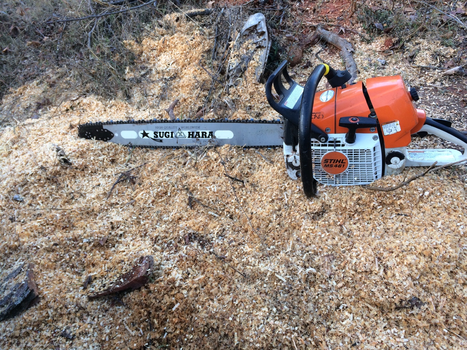

The 461 is kinda what got all this started. I have the 044, but the 461 seems to be all the rave. Then I saw a nice dolmar 7900, both similar, but close enough to the 044 to make them unnecessary. I guess I just like buying stuff haha. I am also interested in a 460 P/C on the 044, and a 660 for milling or an 090... ugh my list just grows.

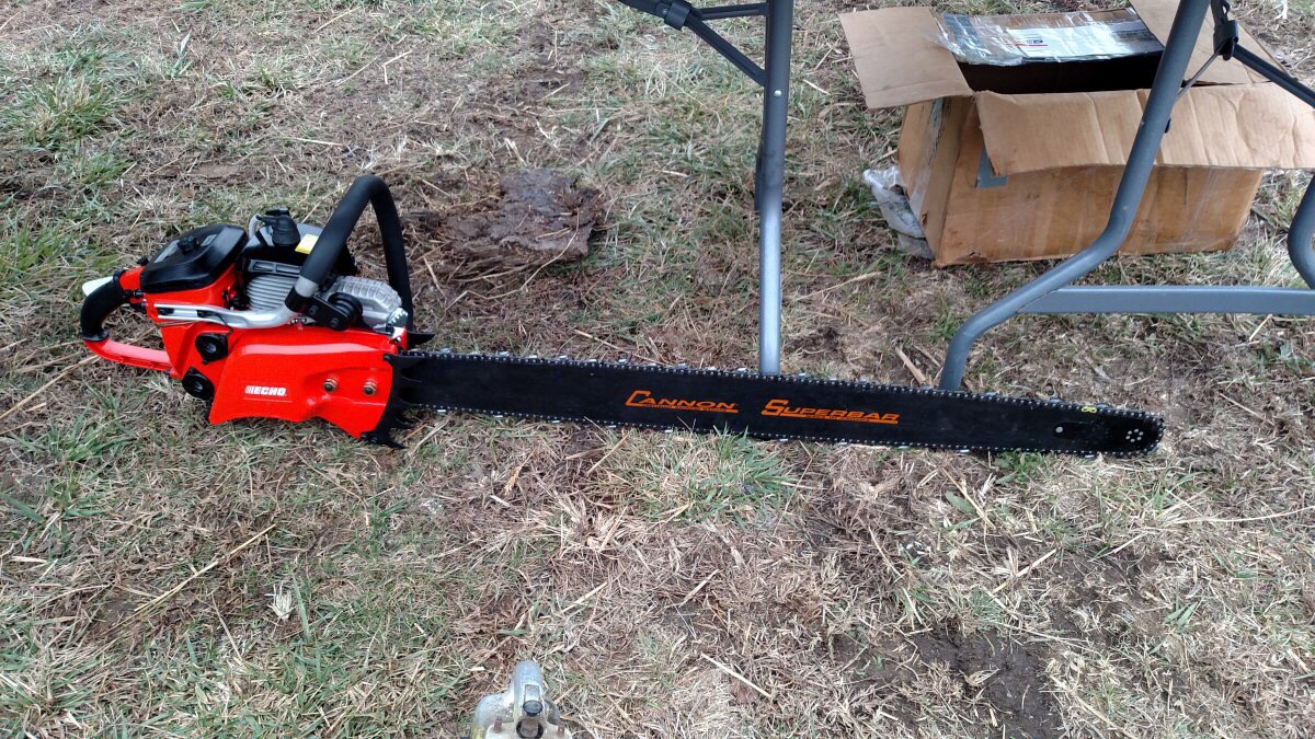

Whats the Echo and Stihl model right after it? That echo looks sweet, a lot different then the local farm stores.
CS-1201. You won't get those here.
Well, unless 1 of 2 people decide to sell 1 of theirs.

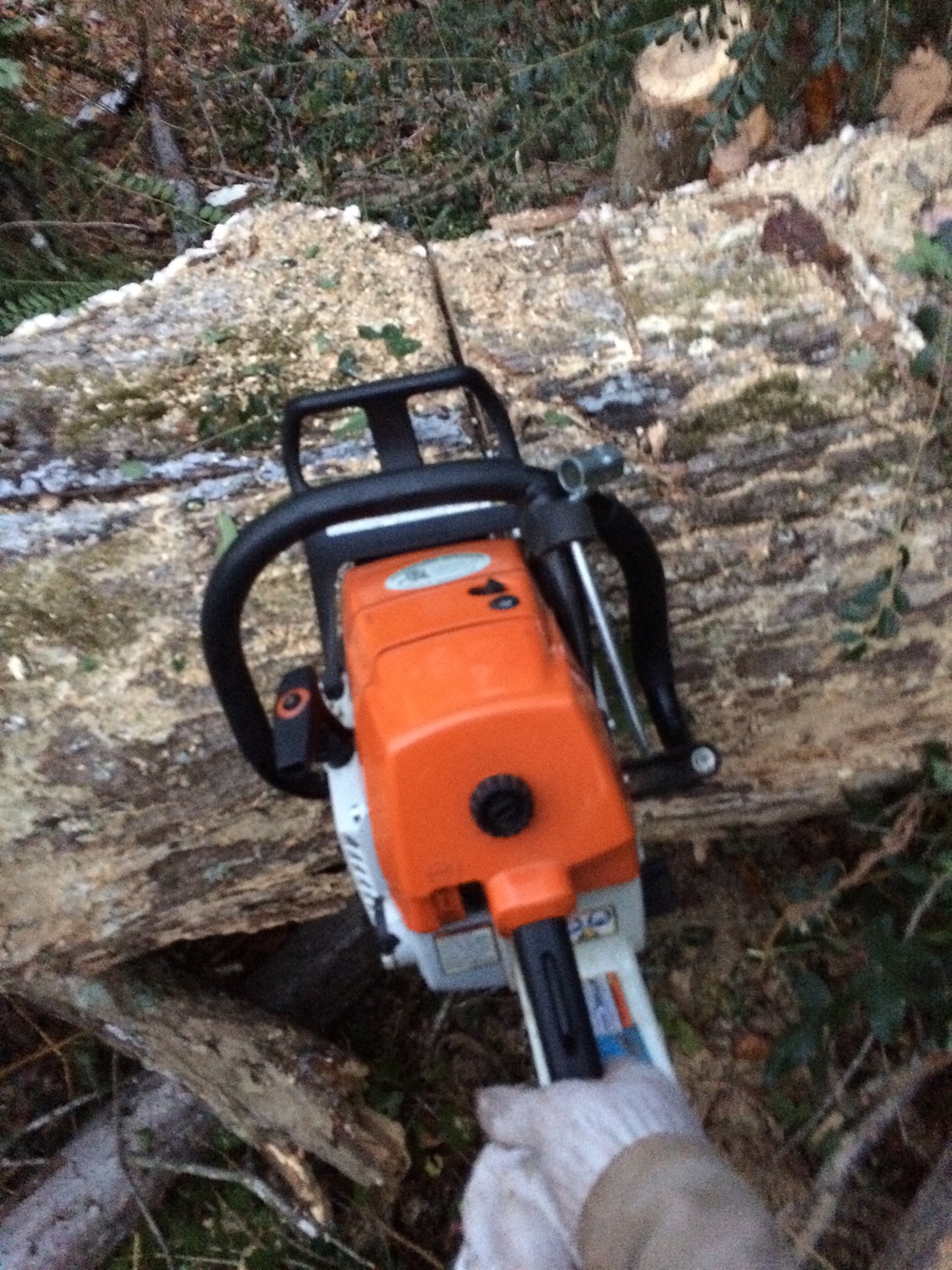

044 idle speed is actually 2,700, acc'd to the service manual. Then they say after setting the L screw to set that, to back off on the idle LA screw until the chain stops running, and then just a tad more. The book also says that an erratic idle in an 044 is likely the L screw set too lean. I have the 044 manual in PDF format if you need it.
I thought we were supposed to set all Stihls like that?
I know I do.

Many ways to tune a saw: tach, no tach, standard default settings, by ear, limiter caps on, limiter caps off (or trimmed), or a combination of them. The 044 manual is old school (pre limiter caps). The 440 is the same saw, but with limiter caps, and the manual for that has this new school method: set L&H to default, set LA to idle at 3300, adjust L screw to get the max revs, reset LA to 3300, adjust L again to get max revs (repeat until max revs setting L at 3300). Then fatten up the L to 2500. Then test throttle response and adjust as needed.
After that I set the H screw to burple/4-stroke at max revs. Then I run it in wood, and adjust until I get a clean 2-stroke sound at max rev in wood, and a burple out of the wood. I tune my saws by ear most of the time. I use a tach to check the settings now and then.
