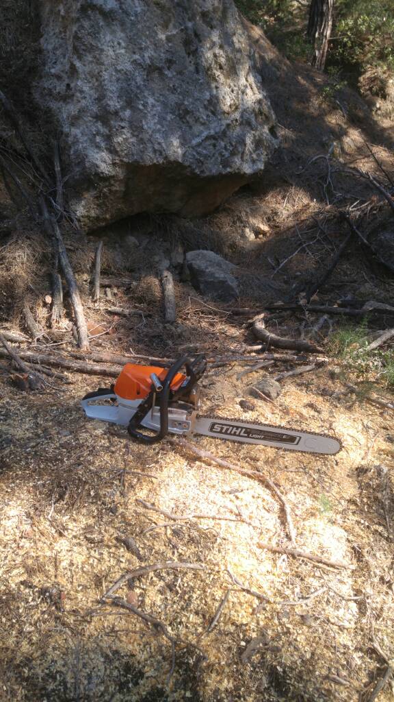

Hey mate, where did you get the wrap handle for it? Or is it custom made?
I can't figure out how some of you make these yourselves.
Definitely want one. :clap:
The saw came with the standard handle. Dan a member here ( @AlfA01 ) arranged me one! Really nice person and always helpful!
