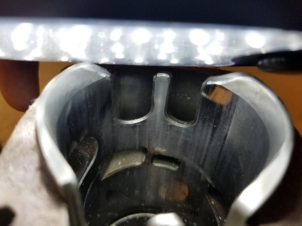

You guys should run a TM Or Redfin 661 if you think doing that made it angry.
I'm not trying to sound like a dick, you guys are all my friends. But there's a better way out there. Just gotta find it.
I filled these to try and get it to stop popping. I ran it a couple weeks ago unfilled and it didn't seem torquey enough. Hoping that losing some case capacity will help that.
Did you fill the original runner up to the cut in lowers, or did you just fill by the base ?

Wonder if something like this would help the front transfers fill up a bit?
Seems it would help fill till the skirt starts passing by. Just spit balling.
