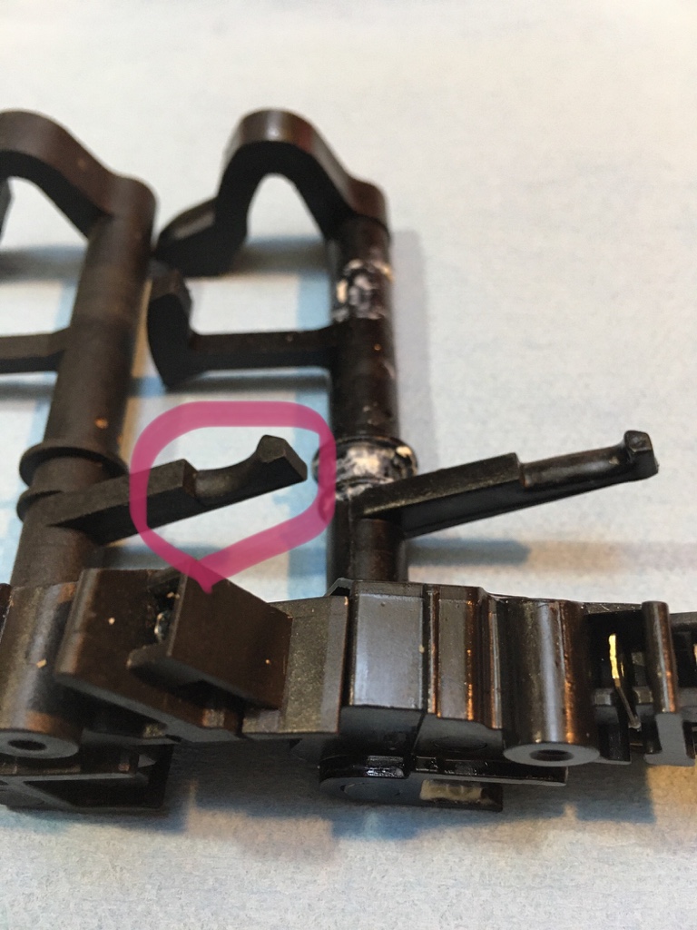

Sticking choke butterfly problem solved.
[emoji322][emoji322]
Stihl part on the left, Farmertec POS on the right.
See the lever that contacts the choke bell crank?
Stihl part has nice curve to it. Farmertec part is just straight.
Found the Stihl control shaft in some misc I had salvaged from a broken tank from a MS440.
Save them tiny bits. [emoji6]
