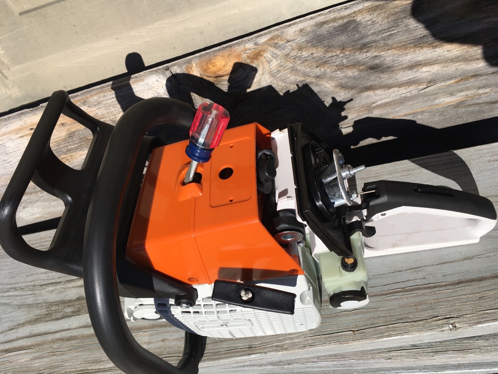

First attempt to start resulted in my hand being hurt repeatedly.

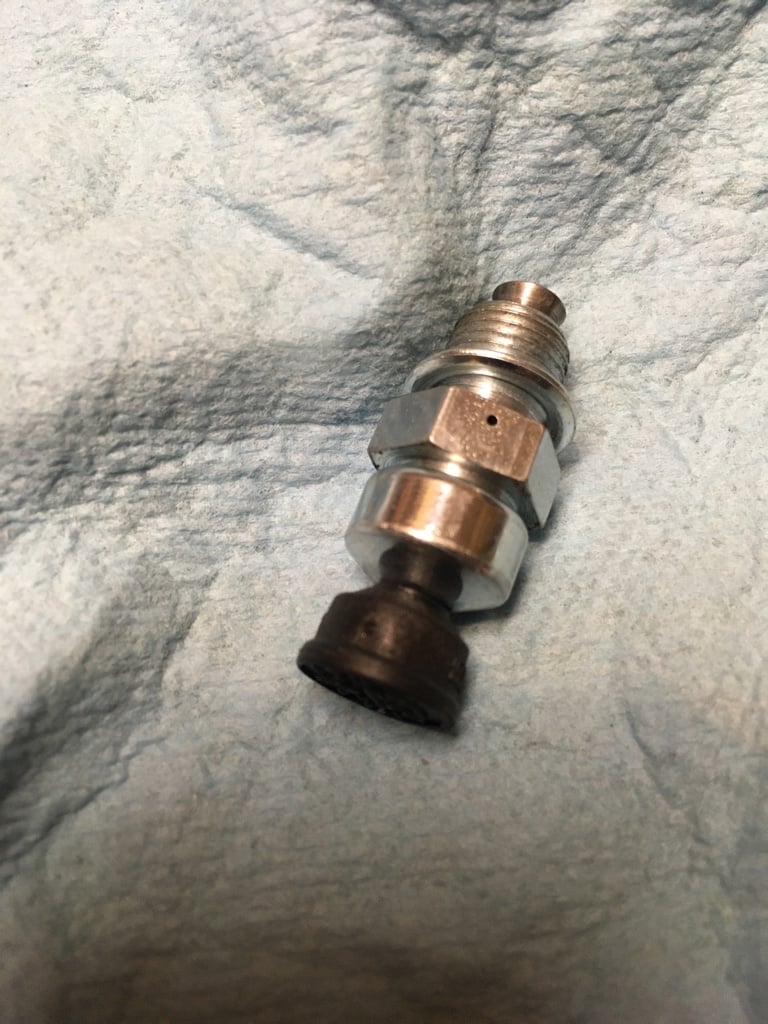

I think I’ll have to drill the decomp bleed port larger.
I did that on the MS880 I rebuilt.
The screwdriver keeps the button depressed so I can get two revolutions. [emoji90]

Almost sounds like you may have some hydraulic lock in the case. Or, sometimes the crank is just a bit stiff to turn at first.
Did you knock it back and forth with a hammer to loosen it up?

I have a .045” drill bit to open up the decomp bleed port.
I had to go a full 1/16” on the 880.

Existing hole is .030” diameter.
.047” drill bit is the best I have short of .062”.

Well, the compression release don’t help much when you are a 130# geezer with tiny hands. [emoji1787]
I think I’ll try the Farmertec release with its huge (.072” diameter) bleed port. [emoji848]

I use the Farmertec ones, just remove that plastic cap and glue it down with Loctite PL Premium. (lightly sand the metal to scuff it a bit, then dampen it with a wet Q Tip).

Got it to run five/eight seconds. Used a release with two .072” bleed holes holding it open with my index finger.
I conclude the spark is severely advanced.
Investigate moving the coil a bit CCW by elongating the mounting holes.[emoji848]
