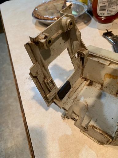

So I'm doing a second one of these. This one is for me. And I'm missing the oiler worm gear. Fun...now I have parts that I didn't have in the first kit.
I have no idea where those hollow rivets go. That rubber grommet. Or that copper washer. The manual only shows 2 of this rivets being used.
Number 8. The rest I dont see anywhere. Anybody know?
Edit: I think I'm missing a washer and they go on the coil.

Make sure you look at the part count because Stihl does not always show all screws in a parts diagram, just one in a set.

The hollow ‘rivets’ reinforce the four fuel tank mounting points.
Flange part against the engine.
