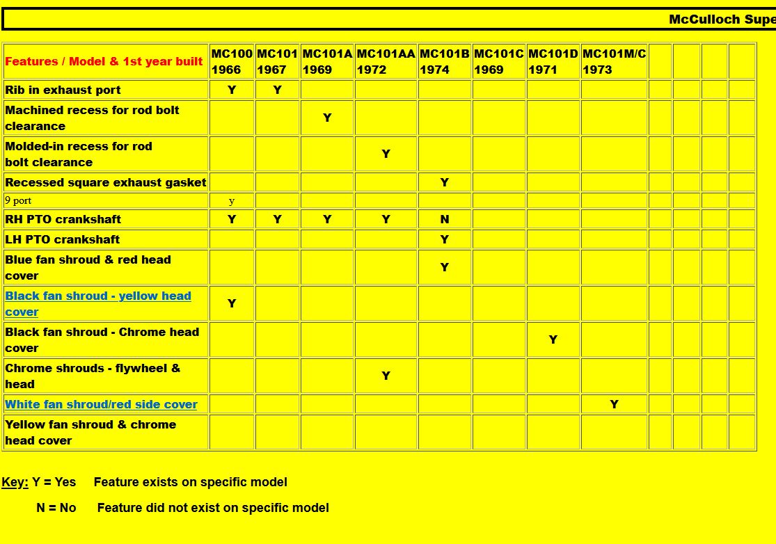

After chatting with another member here last night about Mac Kart stuff, I decided to see if I could salvage some
of the stuff on McBob's old McCulloch website. This chart for 101s I believe was compiled by Steve O'Hara, a long-time
Mac engine guru.
