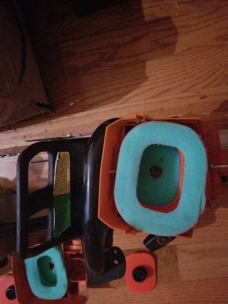

Redbull661
661 hoarder (BlueBallz)
6:41 AM
353
1,056
13,035
wisconsin

Yup. Amazing that air can even flow through it. Lol

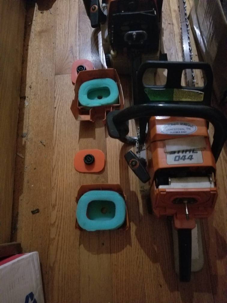

044 used roughly equally with a 261c and 200t over a few days felling and logging dirty gum and pine, not constant but a few tanks at a time with breaks/prep work through the day. The hd2 would've been blocked solid twice at least. Running it without a cover at the moment, when I change filters I might try the cover on, went straight to the plate and didn't even dry fit it. Does anyone know if the 044 has room under the original cover?
Haven't run the 661 in anger yet, I'll try both ways on that too.
Got the whole kit for 661 and just a few filters for the 044 as I'm not a fan of the big cover. Using Belray foam filter oil. I modded an old hd1 airfilter to less than a skeleton, it was a plastic one with fleece type element under fine wire mesh, basically matched the size down to the orange cage they supplied.
I'd got a bit irked with the hd2, fills up too quick and hard to clean out properly. Recently started cleaning them with brake cleaner, wondered if they'd melt but haven't yet
044 sounds great too, what a cracker of a saw

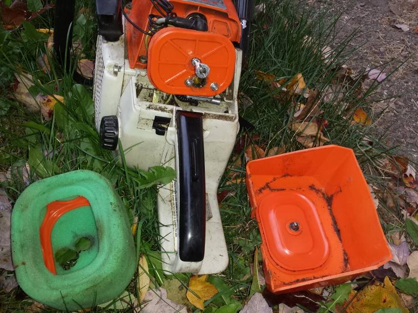

044 with Max Flo cage fits,
but tight.
