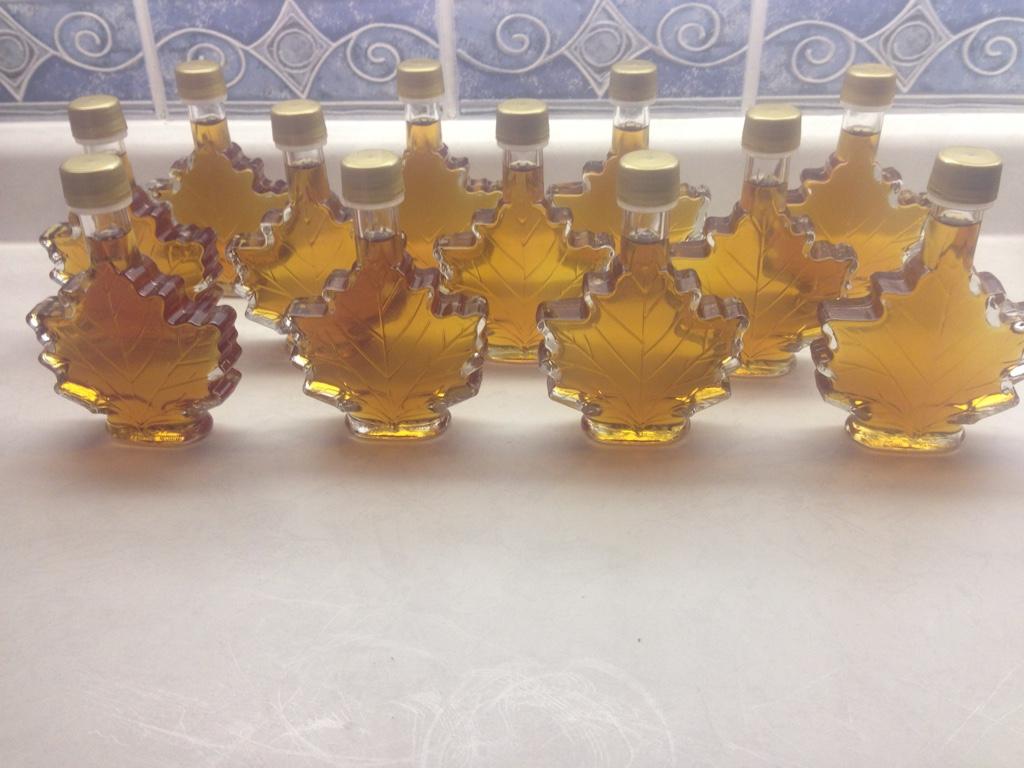

Finally got some syrup in bottles today. I've owned the filter press for a couple years now, but the propane cooker (on the left) and the water-jacketed canner are new for this season. The washing machine is just for decoration. Been looking for a canner like this one for a couple years, but this is literally the only used one I've ever seen listed. It has two big hot water heater elements in the water jacket, 4500W each I believe. Took some work from an electrician friend to get it rolling, but it works great now. Syrup has to be 185F or hotter when it goes into the bottles to make sure it sterilizes the glass and the lid and makes a good seal. This rig will hold the syrup right at that temp so you can bottle as fast or as slow as you'd like. A guy can even take a break and go eat lunch if he's so inclined!!
Anyway, it took a little time getting the kinks ironed out, where to put everything, what each person should be doing, etc, but we got a lot of syrup bottled, and with less stress and fewer people than a normal bottling day the way we used to do it. Also, it was really nice to be under a roof, instead of out in the woods. It didn't make any difference when it started raining this afternoon. We used to do about 40 gallons at a time when we bottled, and we needed nice weather. I think with this setup we could pretty easily do 100 gallons in a day.
