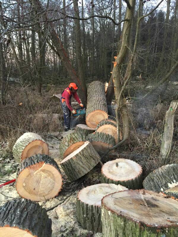

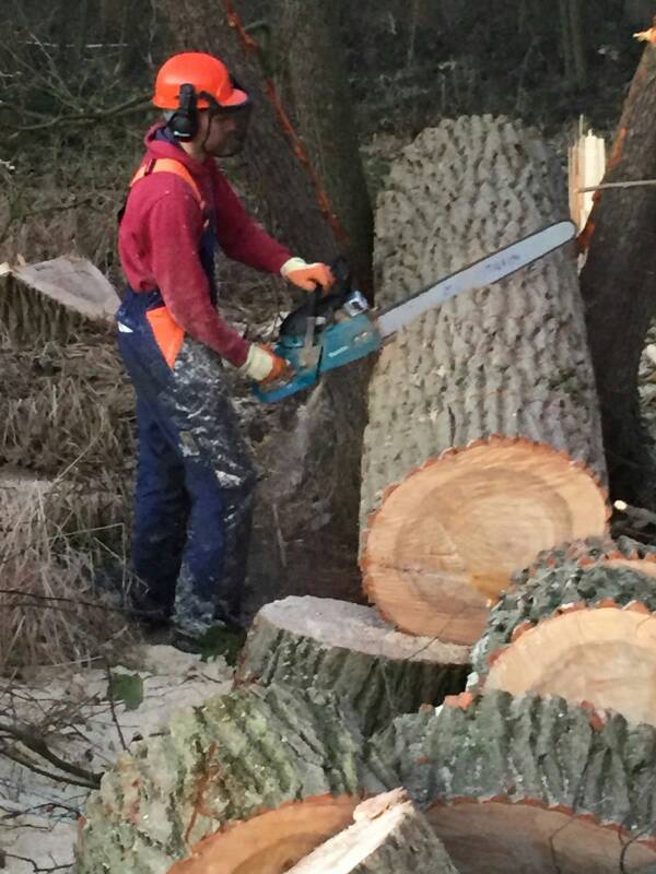

Love my Makita 7910.
28" is about the longest it pull and oils within it's comfort zone.
