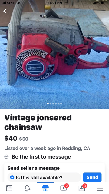

Yep, 621 I would say. Someone painted the silver top red.

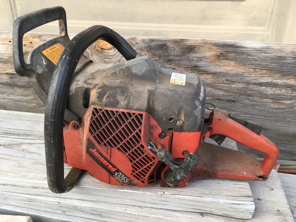

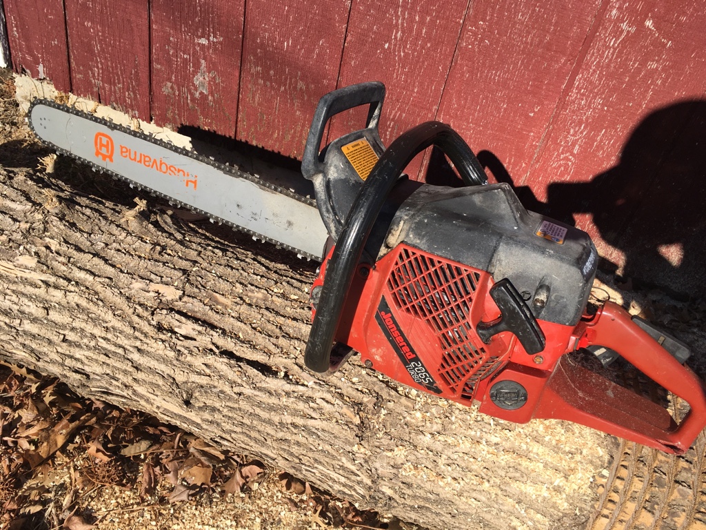

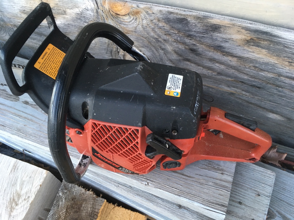

Twenty two year old 2065 from a tree service.
It pumped 155 with good spark so we dove into it. Overhaul the starter and lube the clutch drum bearing.
Hours spent detail cleaning.
Chain adjuster had jumped ship is what relegated him to the storage shed.
24” was only game in town.
Choke handle and chain catcher will put him back in the lineup.
