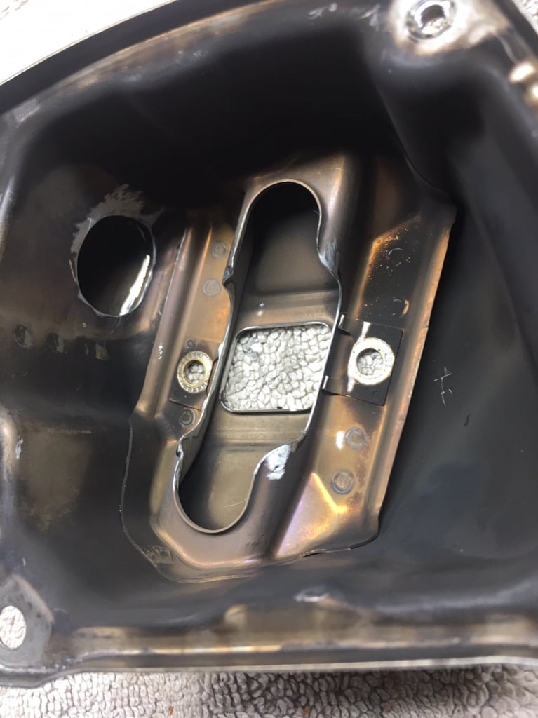

As big as you can go ftw!
From 1/2" to a tad over 3/4" dia
weedkilla

I can't get my head around cutting the section nearest the exhaust. of course you've had it in your hands and I'm looking at pictures on my phone.
Why or how?

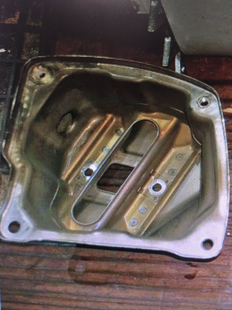

Why cause Ferris's was done like that. And at the top it's way narrower than the width of the port.
How. One hand holding muffler the other the dremel. Rounded cylindrical burr and patience. Stainless steel is *s-word to grind.

Seems like that structure around the exhaust port is for rigidity of the muffler and maybe for noise reduction. Just my guess.
