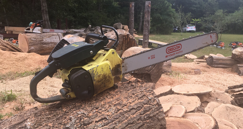

My Pioneer 600:

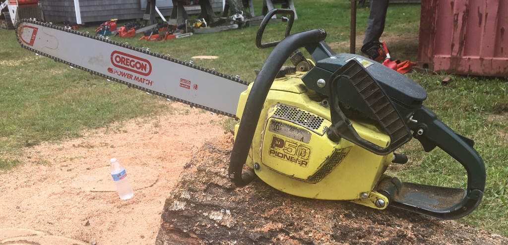

And a recently sold Pioneer P50 I used to have:

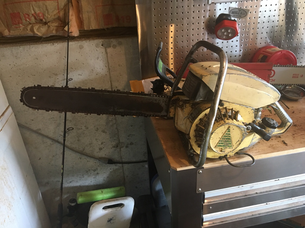

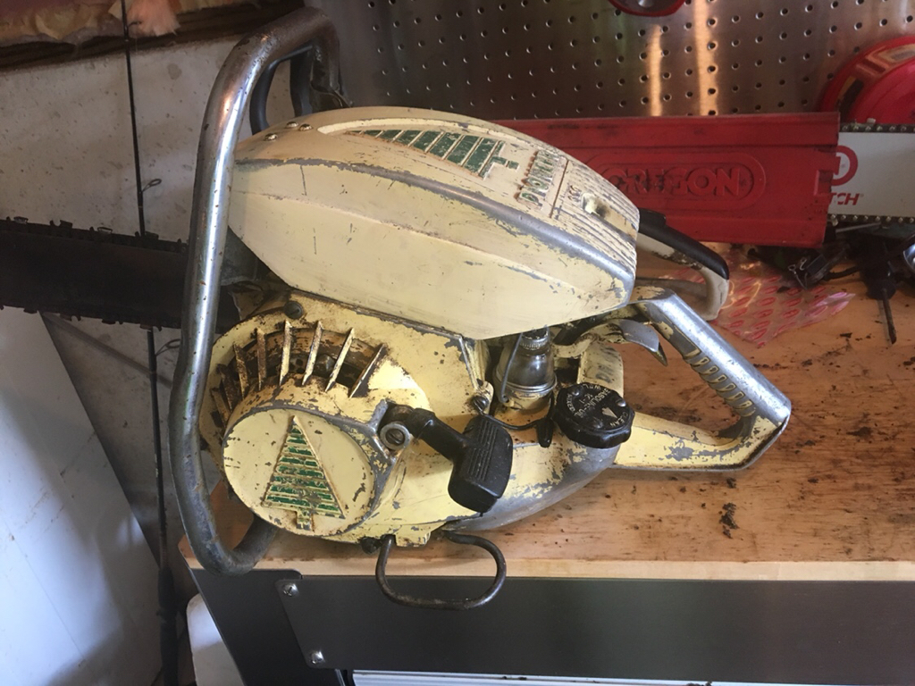

Hello folks,
not sure if I'm right in this forum, but since this is the only Pioneer forum I found so far,
I'll try.
A buddy of mine dropped me an aged Pioneer saw, lable says Pioneer 1150.
I'm looking for any information about this saw before I start fiddling around with it.
The only hint I found so far is a record about a Pioneer 11-50.
but I'm not sure if it describes the saw I have since the model designations differ
(1150 vs. 11-50).
Any idea any body? Here are some pics of my 1150

Here is an update to my previous post. In today's bright daylight I found a type label which I have overlooked in yesterday evening's dim light. It's a 11-50 by the type label and made in Belgium. Did Pioneer outsource production or was it a licensed build?
The saw's body on the opposite side beneath the bar mount says it's been made in Canada:
So what's right?
The saw seems pretty well preserved and hasn't been used for many years now, but before that it was a runner according to my buddy who owned it. Below the only problem I've found so far: A crack in the sprocket cover.
Is this a saw worth to restore and keep running? I have no idea since I'm absolutely new in the Pioneer realms.
