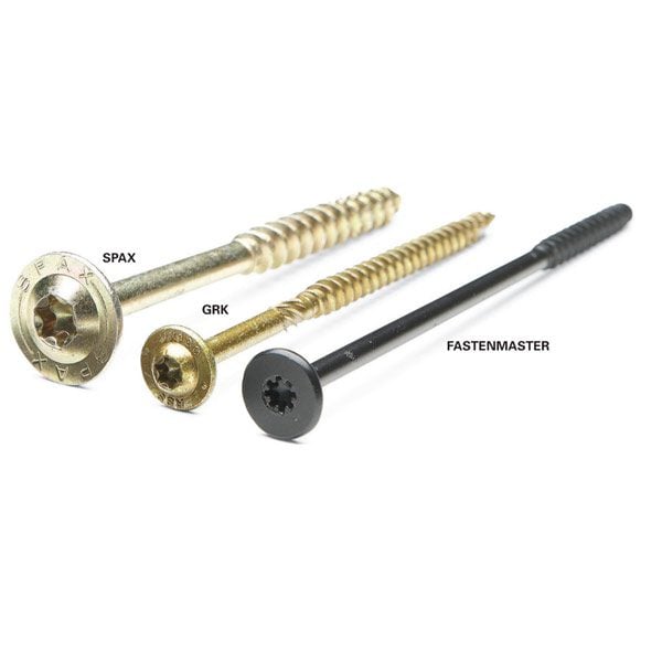

I have been using these black bolts that have spline drive tips ,screw right in and no hole to drill like a lag ,1/4 cordless impact gun seems too drive them through a 6x6 pretty easy ,impossible to cut through with a sawzall ,kills the blade real fast

I was having a problem with reg galvanized lags twisting and breaking in the doug fir without drilling a pilot hole using the electric impact ,these and a company called ledger lock are super tough ,kind of spendy though compared to reg lags .Work great for deck framing .And timber type work .
Some we use are just like that. These are 5/16 hex head
But they don't go in with a cordless. Need a low rpm corded drill. Sometimes the drill rips right out of my hands... Lol!
Those are one of the style i use also ,the long ones like that ,are you using a cordless drill ? or impact driver like this ?

Cordless won't get past 6-7".
I use this
Even a regular 1/2" drill won't put them down. I burned up a couple Milwaukee drills. In the heart wood I had to grab my right angle drill to finish them. But that low rpm dewalt is a strong drill!

I've used an 18 volt Makita impact to drive stuff that a drill would never drive. Those things amaze me.
I haven't tried a 1/2" cordless impact. It would probably drive them but it would be loud and I was worried they might snap. Maybe work real well though...
