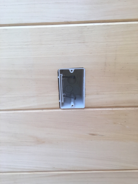

Here is a better picture.
I love those old work boxes. It's much nicer to attach to a stud than use the finger type on the drywall.
paragonbuilder
12:29 AM
384
Jan 2, 2016
9,229
33,871
Norwich, CT
I just wish they made them in a narrower depth. I'd like to leave a little more meat behind them for insulation purposes. But I'm not complaining when I'm tucking joints in the boxes...
