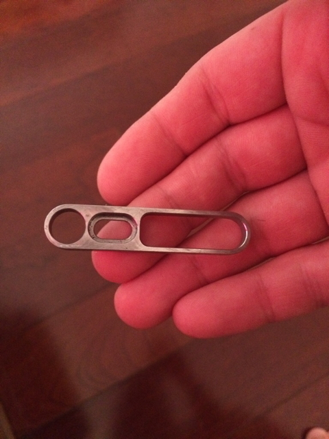

Alright.... this may sound strange but I have stihl mount bars.... has anyone found an adapter that works on the 562? Heard there are a couple that would not work
Studs to close together?

bar studs are too close for adapter....i tried it. We just modify it or what?
fyi: my adapter fit on a dolmar 7900 but not 562
That Dolmar 7900's have studs that are closer together that I think Homelite410 makes a special adaptor for. The regular who he makes should work fine. DDave as C^3 should sell both.

I have modified them adapters to work with various saws. However I usually now just use the correct bar for the saw. When the stihl 28" light came out, I needed it on my 681 Solo. I got some adapters with Sugi bars once that looked like springs......I tossed them not knowing what they were.:(

this is the one i got. drill it out???

I remember trying that one on a 562 somebody's I knew.... it did not work you are correct. The other one looks pretty promising.
Any bar mods needed?
