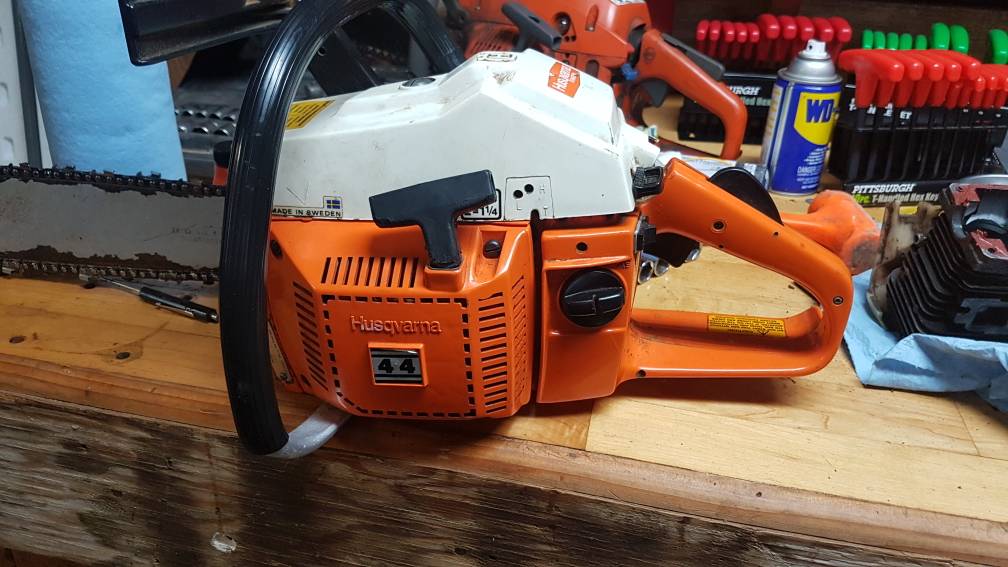

I was afraid of that, saw is in great shape , just scored cylinder

Did , cleaned up fine , starts and runs , but runs out of fuel on top end , going in carb Sunday

Cleaned that one up , it looked like hell , but was not damaged bad at all

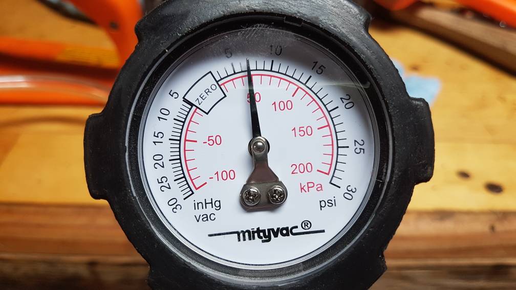

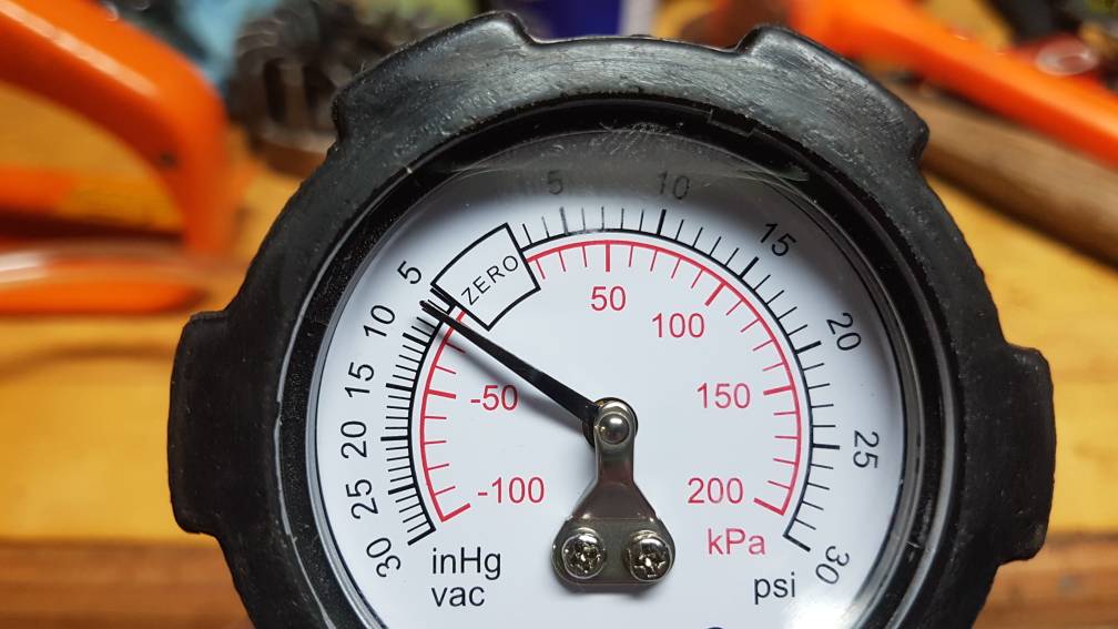

The ring was barely stuck , came right out , cleaned groove , 1st test was 122, ran it a bit today, a lot more compression, going to psi test it Sunday,

P and V test revealed a ad chain side seal , got to find one and the 44 will be done

Nice looking 44. Looks older than mine. Mine has the gray cover, think I bought new around 1984/85
