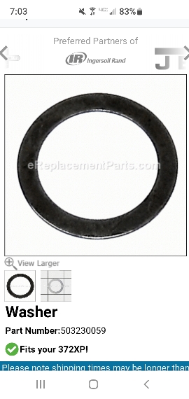

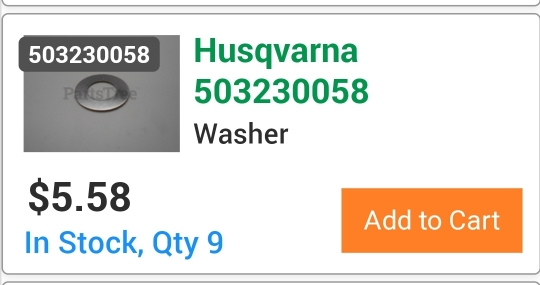

Here ya go

it wouldnt happen to be same one as the 372 ?
They're not the same. The washer for the 372 rides on a separate bushing that slides over the crank. The washer for the 395 rides directly on the
crank and stops at the stub shaft shoulder just above the main bearing. The two washers have completely different dimensions.

you wouldnt happen to no dimensions of the 395 one? i am in canada and dont have a very close dealer and cant find one online

I don't know the dimensions offhand, but you don't want to throw any old washer in there. This is a thrust washer, hardened and made for axial loading.
