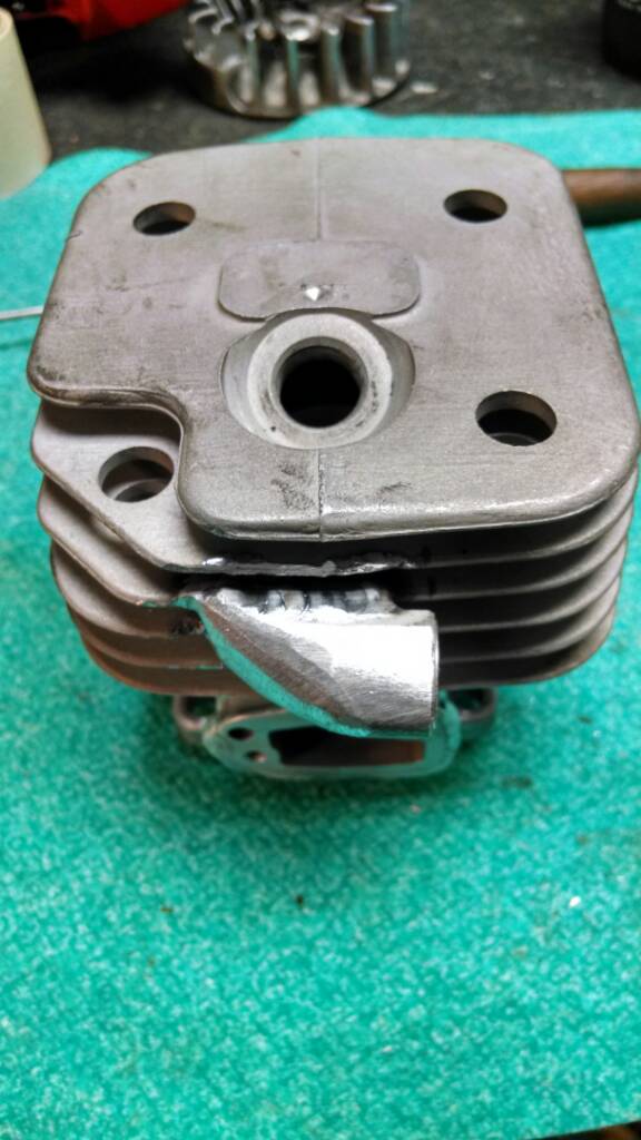

I did notice the odd piston, but didn't recognize it. Sounds like a good plan.Also notice the 52mm ms460 piston in the pic. It doesn't bottom out on the case and laps the exhaust floor by a good 3/16th inch.

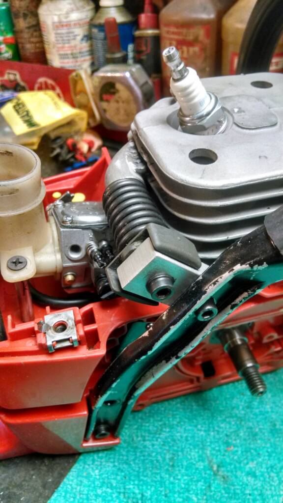

Like this.I'm curious how you gonna connect upper handle to side of cylinder?
Like this.![]()
Let me know when you get yours done, I need a good recipie for mine.![]()
There is no stroke difference however I think my case is too tight to feed 72cc. I haven't worked on mine in a while as I was a Lil burned out when I finished it so rather than half ass it, I shelved it til I have the love for it again. It did run, I have an air leak, however my 350 is my go to firewood saw. Really looks like a pup with an intenz bar on it.
Go with a 254A I have one on my ported 272 and its plenty... And has idle adj built in.I would consider the Tillotson hs from either same saw, or as long as it has the low idle adjustment. You have plenty of options and I think either could work. Certainly gonna take some work, and as I'm typing this I believe this cylinder swap has been done before, I just can't remember when but believe it was from the Nova Scotia area.
