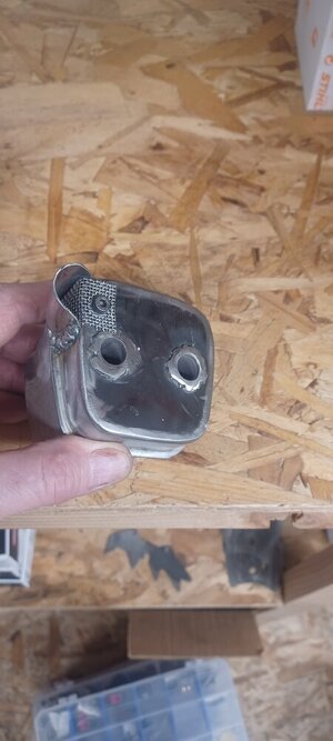

Win the opportunity for doing a muffler repair or replacement. :thinking:
I picked up an aftermarket muffler cover and after weighing it decided it might not be a good idea to add over a half pound of extra weight to the front of the mounting bolts. :eek: YMMV
Doc said he wanted to try to fix it...so I sent it to him..
Never heard anything back...so I'm assuming he couldn't fix it.
And I agree about some of these aftermarket covers...too heavy for the mounting bolts...especially the stwaight shot.

Main thing on the 585/592 mufflers is the cover plate. It comes loose and rattles around and starts beating the mounting tubes that run through the body of the muffler. Those start to get loose and the whole thing rattles itself apart. A good buddy just had to replace one. Like the early 3120 mufflers, a guy has to check them every few hours of runtime.
Removing the triangular cover and leaving it off seems to be the only solution so far.

Have seen several with the case threads wallered out on the bottom muffler mount from heavy AM replacement covers.
Just tac weld it :p
Need to remove the muff? Grind off the tacs 😃
