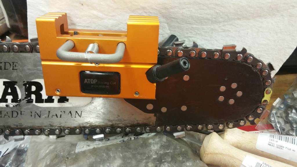

Yes I have a atop guide. It is a good learning tool. But not perfect. Took a bunch of adjustments to get it good on both left and right hand cutters. Mostly level and centered. Did not like using it on the bar. Cutter moved to much. Plus it is not for durability of cutter.
There is no adjustment for different angles. You get what you get with atop. For novice it will help you learn how to hold the file to get started.
