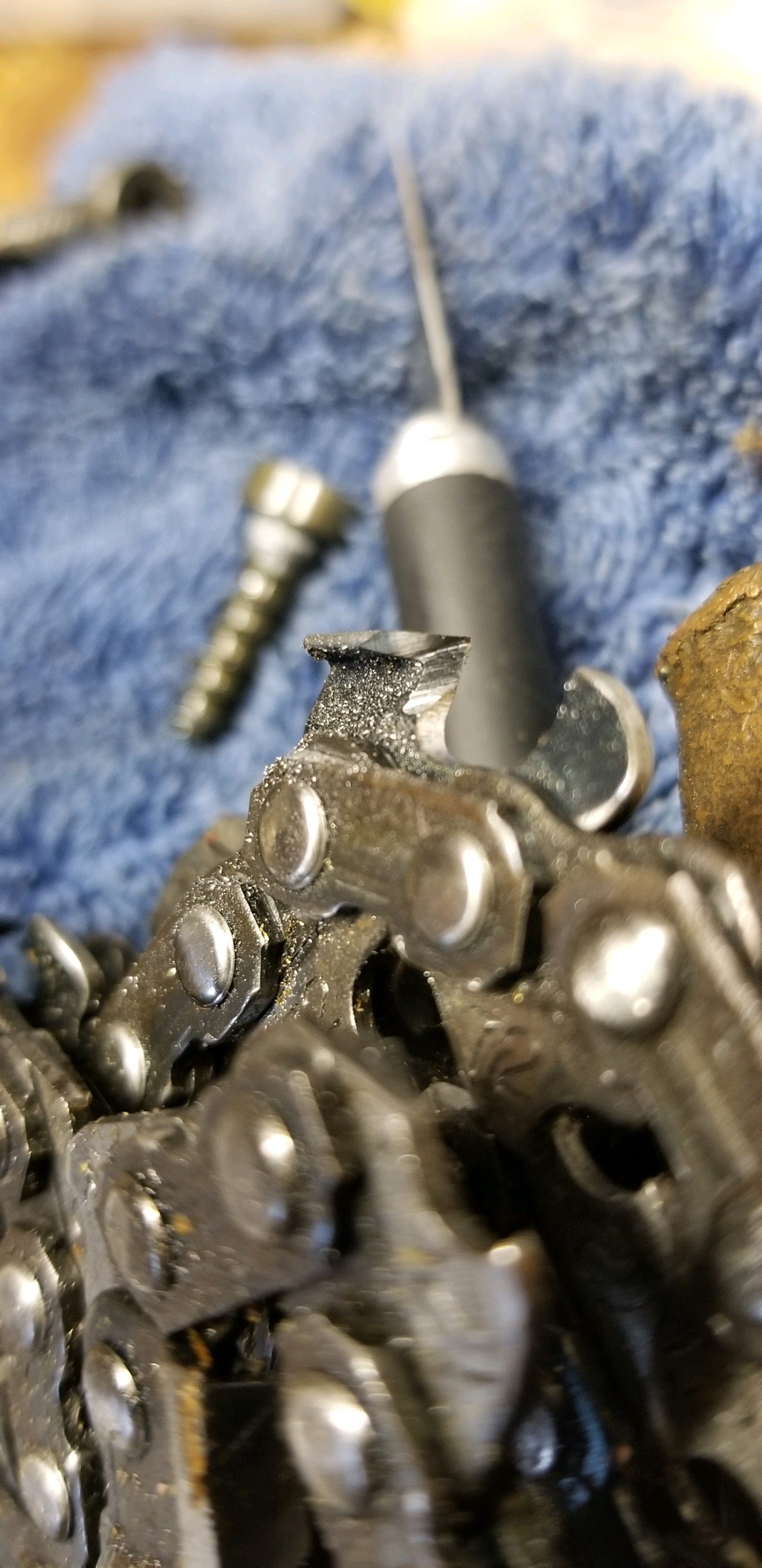

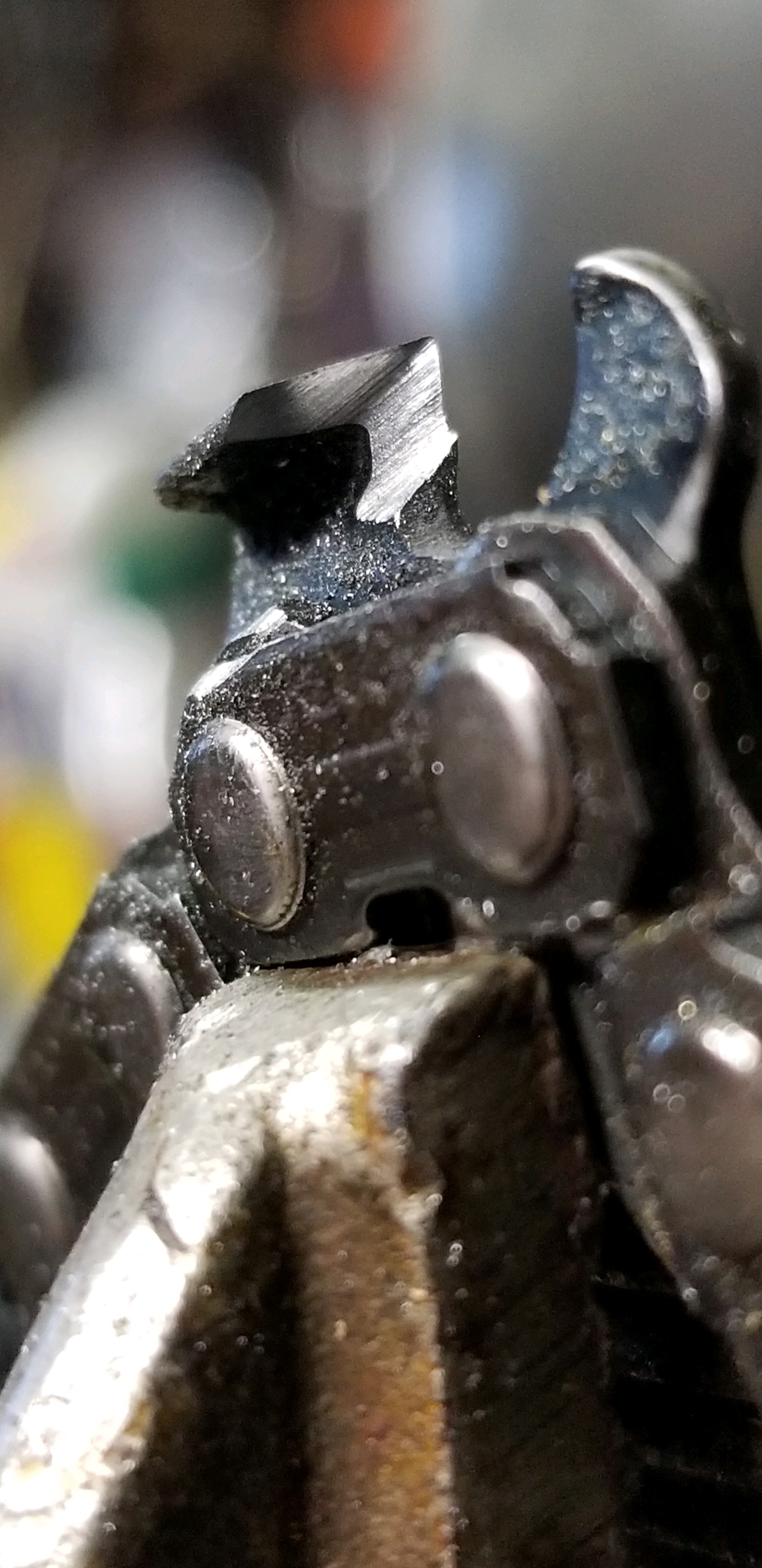

I never took into account any angles. I just tried to get the file to line up into the corner of the cutter. Here are a couple pics from when I hand filed it.
