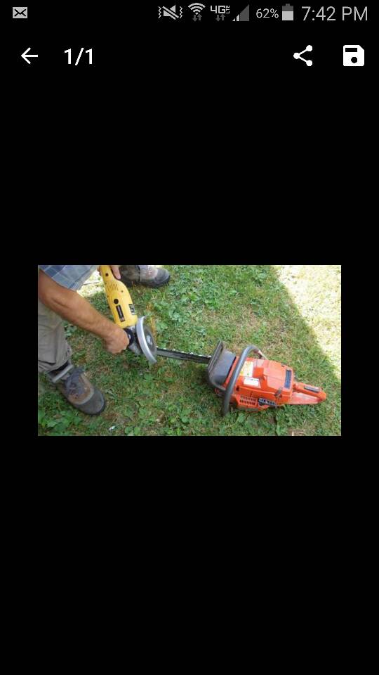

I cut some hedge today,need some tips to sharpen my 30 inch blade .View attachment 19401
Pull the cutters off the machine, take them apart and sharpen them one cutter at a time with a hand held grinder. Follow the angles there and keep in mind that they cut at the corner where the blades meet
