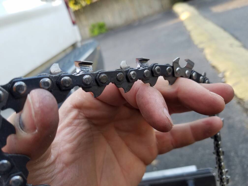

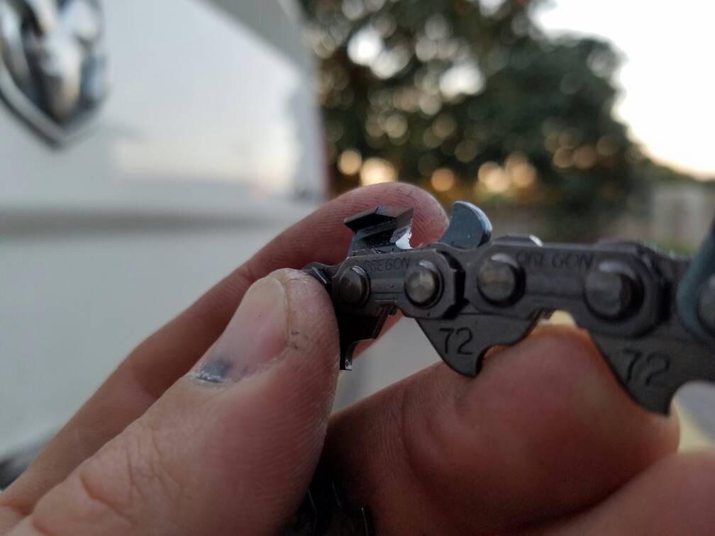

Looks like you nailed the cutters ,but with square you can keep the rakes a little taller and be ok
Danders
3:21 AM
139
76
144
Forest Grove, OR
The 359 felt like it wanted a taller raker. This chain came this way on a saw I bought, only thing I did on these is try to smooth the ramp up to the raker. Sure doesn't look like it from the pictures though.

I touched up the chain on the 359. Is it helpful when cleaning the gullets to angle the file similar to the top plate? I filed this one perpendicular to the bar. I don't think it's cutting crooked, I just wasn't paying attention on the second cut.

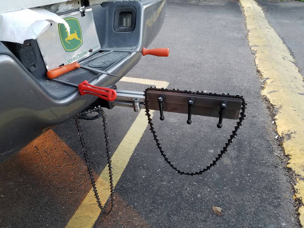

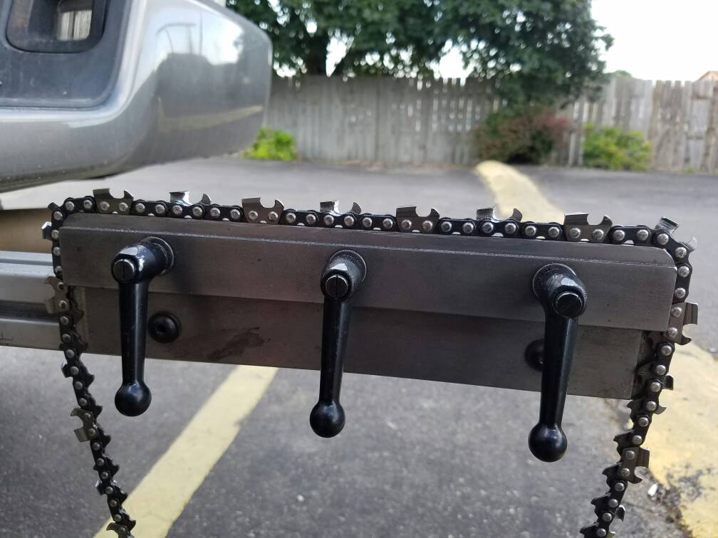

My evening before dark.

Did you use a chair or just kneel down to work on the chain? Nice use of the scrench.

mdavlee
Hillbilly grinder

Douglas Ostrander
5:21 AM
8
Dec 4, 2015
868
5,518
Waukee Iowa next to I80
How high from ground do you like to have your chain to square file. Waist, belly, rib, chest, shoulder chin high? Feel my vise is to low.
What works for you?
