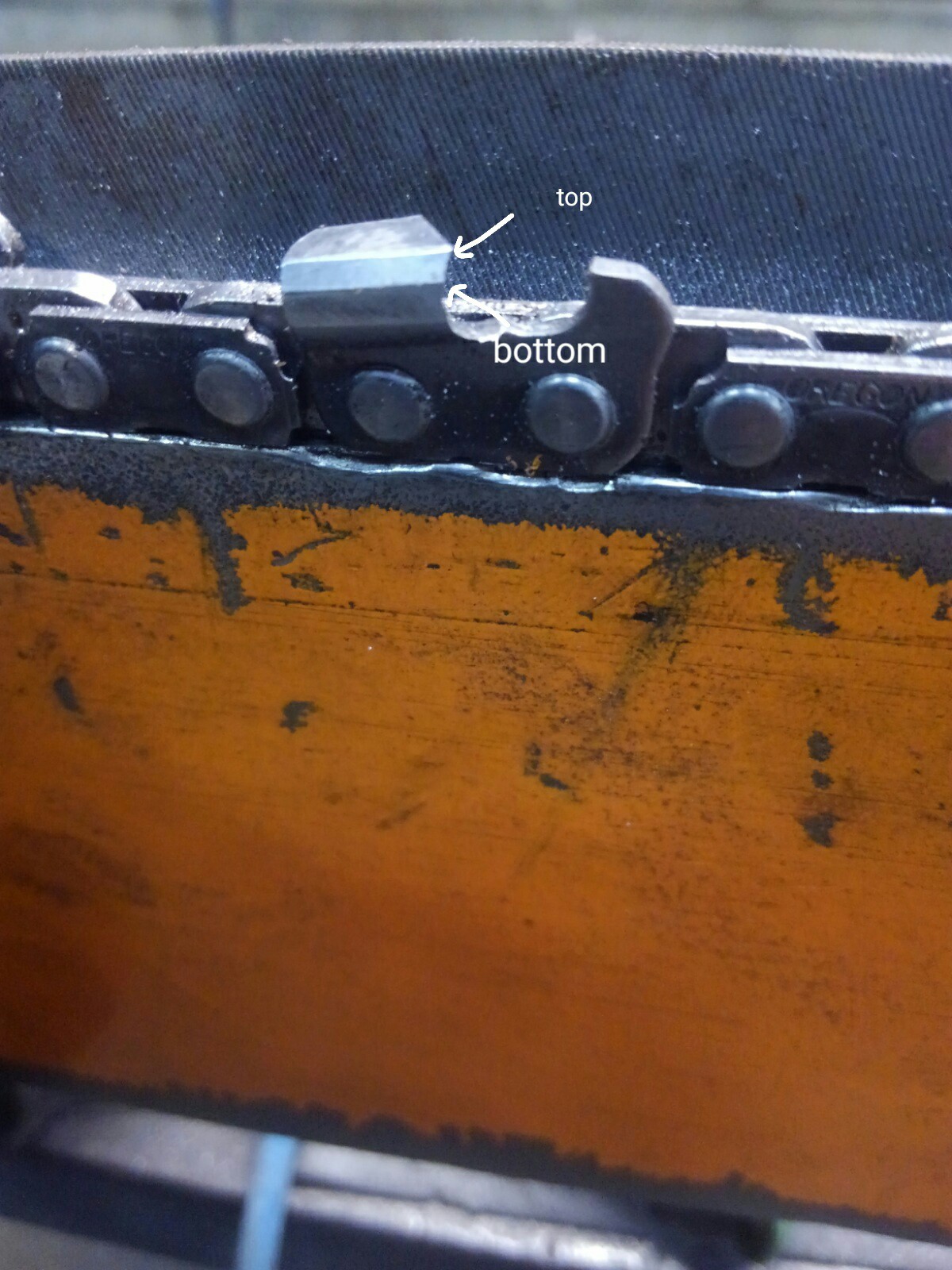

You should be able to square any full chisel cutter. Needs the square corner. You cannot square semi chisel chain.

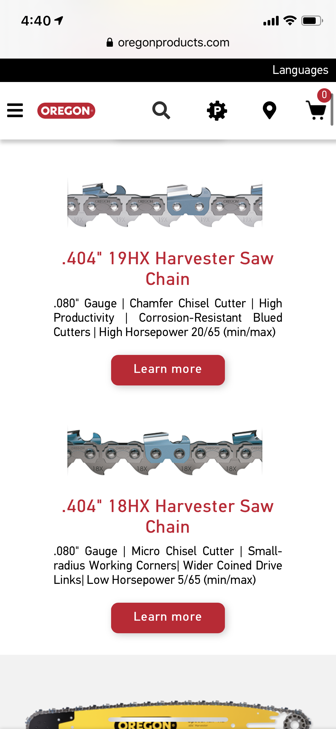

Not always true remember this harvester chain it’s a different animal to start with. What I’m trying to get at is sometimes the cutters are much larger then standard 404 cutters.
This GB 404 harvester chain

It also looks like semi chisel.
But I hear you sir.

I am with RI Chevy here, my understanding of "Full Chisel" makes that chain look like semi or something in between of chisel/semi chisel at best.
This is Skeans1's picture cropped but not resized for those that read the forum on a small screen.
If the manufacturer calls that chain Full Chisel then there is something wrong with the definition of Chisel tooth.
