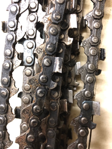

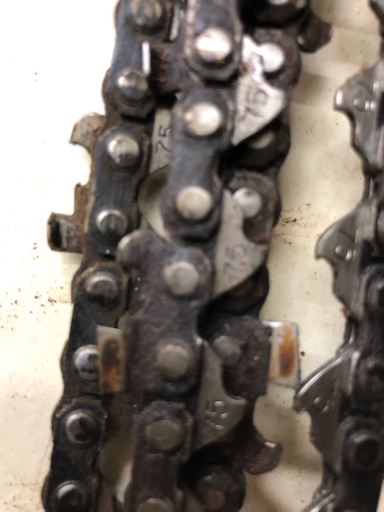

This is my first experience with a square cutter, so I'm not real sure how much different it should feel while in the cut.
It all depends on the angles. Really sharp with forward lean will be really aggressive with .025 rakers. On the other hand, blunt angles with minimal forward lean and .030" rakers can be smooth even on a 50cc saw.
346 runs this just fine. .028" rakers

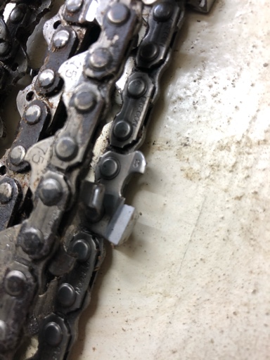

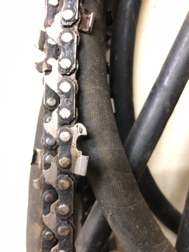

All these chains have different power heads they live on so the grind is adjusted depending on one it’s used on. One is a 60” the full skip that goes on a 395, one is a 42” semi skip that can go on a 395 or a 390 which the tooth won’t be enlarged like it will be for the 395, the 36” can live on the 372, 390, or the 395 in which case the 372 grind will difference like the 42 but the 390 or 395 will share the same grind with a sprocket change, and the last is a 32” which can live on all the above as well as a 562.
