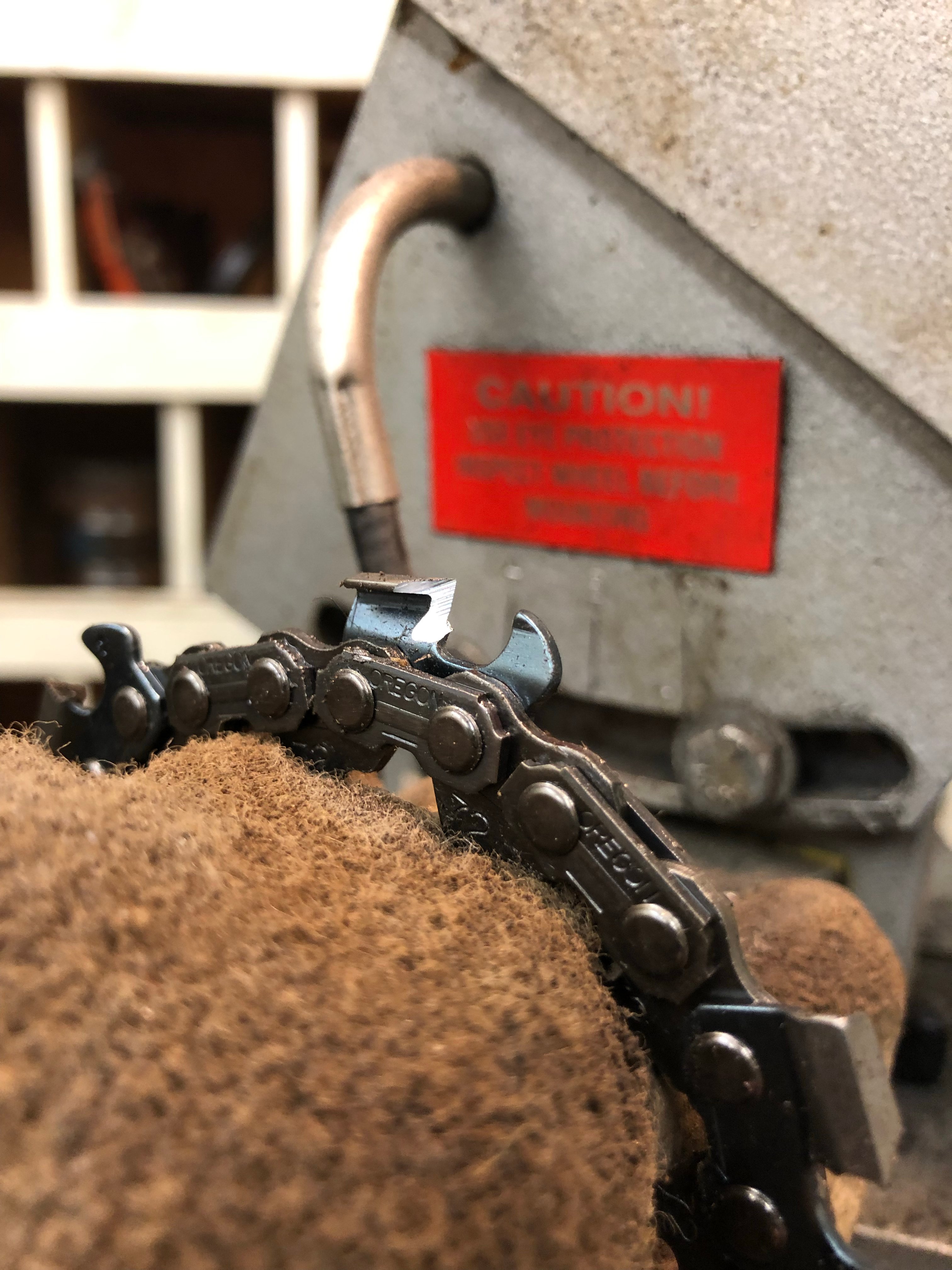

Could someone post pics of a more work/firewood oriented cutter? I think my angles are a bit aggressive. Could be the wood. Oak, Mulberry, and cherry but I got 3/4 of a tank with the chain I did and could see it starting to fall off.
Straight off the grinder this is normally how my cutters look.

What are you guys using for top plate angles? The witness marks? From the photos, they look like 25 to 30*.
