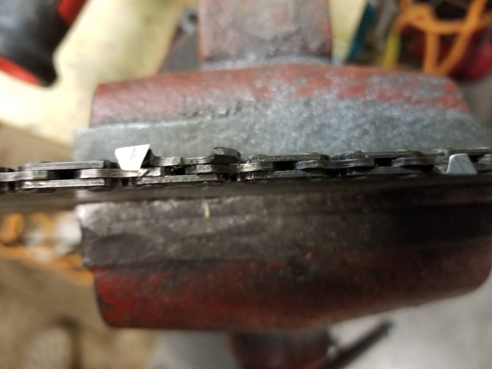

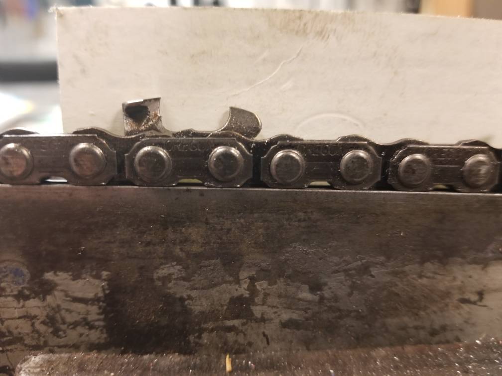

This was an idea after I sharpened one of my knives with a ceramic rod. Homemade 5" long ceramic tile honing stone. The tile piece was cut 45 degrees so the back had the 135 angle like a square file. Then thinned down and slightly trimmed up. I tried to get the same angle and zoom for the pics. The corner was hit with about 20 strokes back and forth while pushing up in the corner then about 20 strokes back and forth with wd40. The top plate and corner is at least twice as sharp as just with the file. Hard to tell with the side plate. I do not think it is some thing I would do unless I was going to race a chain.
Before
After
Ceramic tile hone - piece on the left.

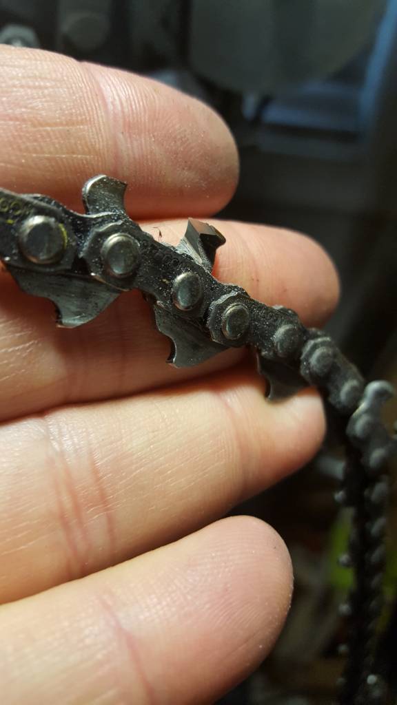

I’ve been experimenting again. Mainly goofing around with rakers trying figure how to make them clear better without letting crap through to the cutter behind it. I think I need to make the face flatter, I’m getting there.
Oh the pain of not having a nice chain vice...lol
I converted this round ground chain to square. Takes a lot more than I thought it would. This chain was a little over half used when I started.
I converted his round ground chain to square. Takes a lot more than I bought it would. This chain was a little over half used when I started.
Smooooth!
