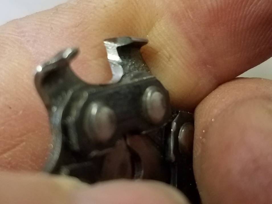

Still practicing.....but I think I'm getting closer.
I've got a bunch of Vanguard laying around so that's what I've been using. Until I get it figured out.

Looks good. I hate the looks of that chains rakers though.

I cut a swamp cheery tree down. Very twisty grain. Some pieces that I didn't want to try and split I cut up using my MOFO 036 and my square conversion chain. I have to say it cut very well. Here are a couple of pieces that I noodled. And a pic of a tooth. Chain is a bit dry on the sides, and tooth probably needs a touch up.
Notice no tooth marks at all in the wood. I remember John Reilly saying that was a good sign.

Kevin, that chain came as round with a saw I bought on CL. I did notice that when I took it out of the box. Hopefully as I sharpen the teeth, it will get better.

Noodling is a whole different ball game, even a good round filed chain will cut it smooth. Check your cross cuts. That's where the square pays off.

Looks like the corner is off, has some top beak. The side plate angle could lean back some more, but that will probably fall in line as you continue to file it. I've notice that when converting from round it can take some effort to get the side plate correct.
I like an aggressive depth gauge, but that one looks too aggressive. How did it feel it the crosscut?
