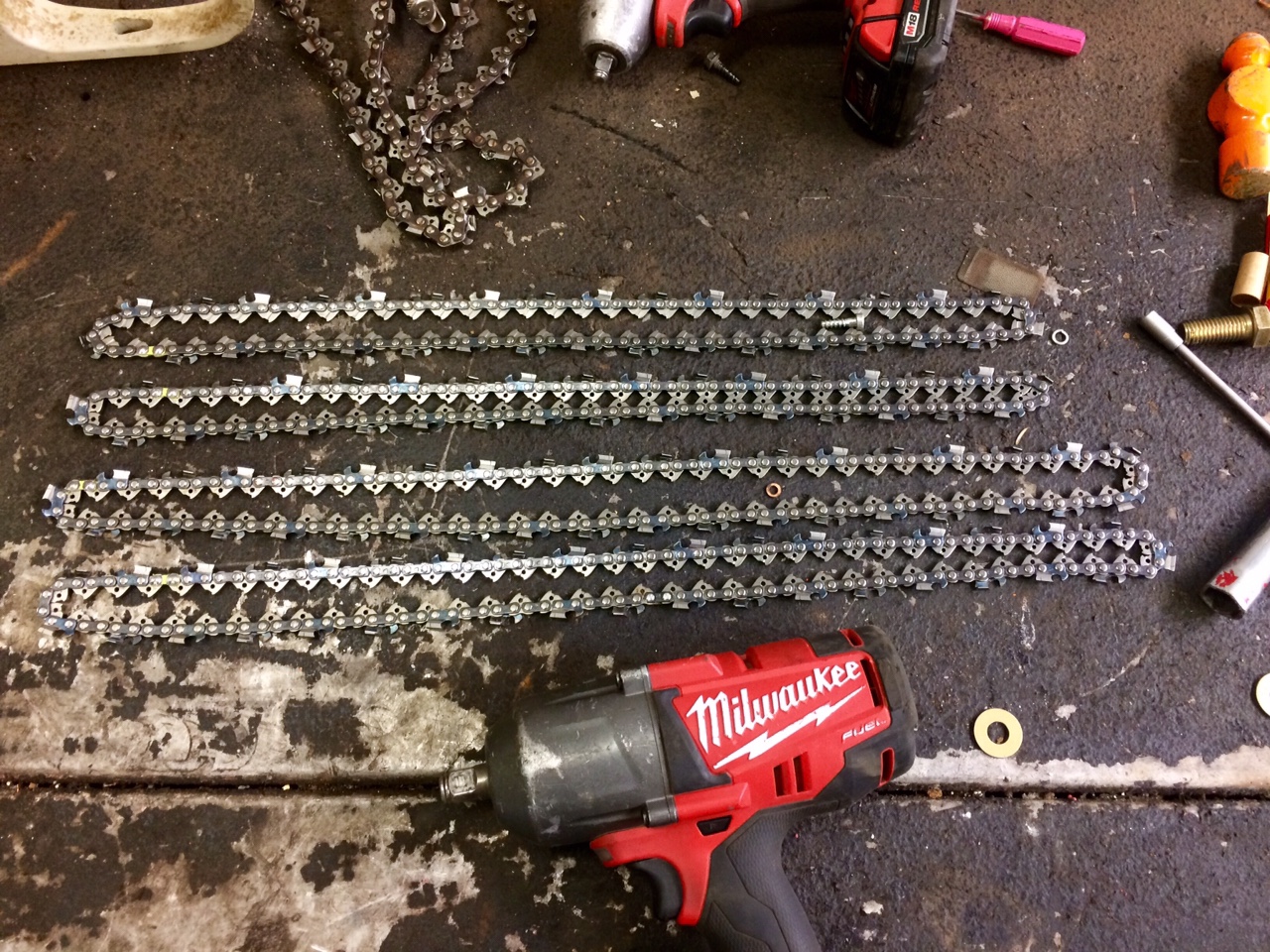

Hey Ri you run .325 .063? I make a lot of chain and save the leftovers off the roll. I can piece you a few together what ever length you run. I have a few decent used to. Just cover ship. I don't have a saw with 325.
