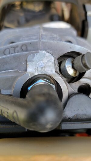

Thanks, everything on it is oem that pa dan and Mike got for me. I think it has an 066 jug that scarr ported, and I’m pretty sure he did some carb work on it as well.
Wasn't that the JMS disaster that had a bar stud pulled out and it was cracked almost through the bar pad? If so I'm glad I could get it fixed up!

That’s the one, you did alot of work on the saw. If I’m not mistaken, you put 661 bar studs in it for me, and then machined it down. I know it was a pia with the old bar studs. Now the bar sits on the studs, like it should. Seems like it has more of a lip, or shank on these bar studs. Been awhile, not sure everything you did scarr. But you saved the saw for me. Thanks again

I just put modern 660 bar studs in it and then counterbored the clutch cover to fit over them.
