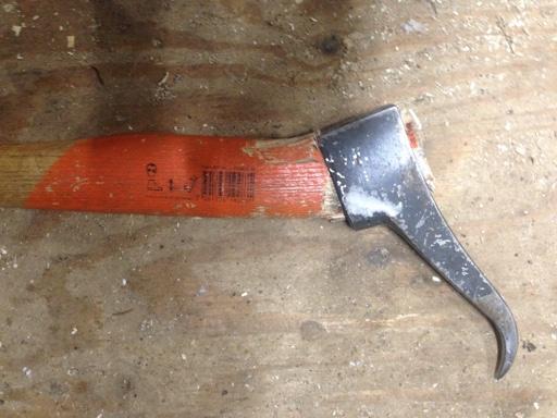

Husqvarna pickaroon handle update 2
I love the pickaroon and the head design, but the handle was not impressive from day one. Seems like ash, but not tight grained at all. Almost soft.
Because of the angle of the tip, the striking force creates a twisting moment on the head. The wood on the back of the handle failed under compression and then the rest of the handle sheared off.
I shortened the handle 4” and I’m back in action. I have a nice piece of hickory set aside for a proper replacement.I’ve already taken a template of the original.
I’m not really complaining. It’s survived 75 cords worth of blocks so far and I do freely admit to routinely carrying >24” dia rounds hanging off the tip. And sticking rounds at 20 below takes a lot more swing than above freezing.

Update 3
A year later and the handle is another 4” shorter. My hickory handle is still a blank and I was cutting blocks , so I bought a Logrite. Not sure I like it better than the husqvarna, but it is certainly tougher. I’ve had it a week now and finally getting the right swing for it. The tip angle is straighter so a different swing is needed. The husqvarna with wood handle and heavier head feels better balanced and the axe handle shape makes for easier lifting, but the Logrite does stick well. The round handle I don’t like though. It should be oval so I don’t have to look at the tip angle. Eventually I will complete the replacement handle for the Husky and then do aside by side.
