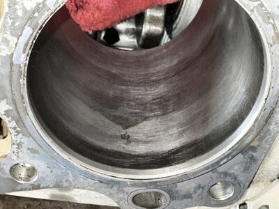

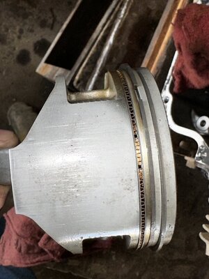

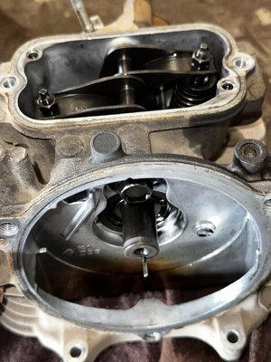

Never liked this thing, never started for crap, carb/choke wouldn’t work well. Started blowing smoke and found the cyl damage. Everything else looks ok at a glance.
We bought a predator.
No idea what it’s worth. If it can help someone out, I’d like $200 to box and ship.

Y’all think it might run ok with that cyl honed as much as possible and convert to a std dumb carb?

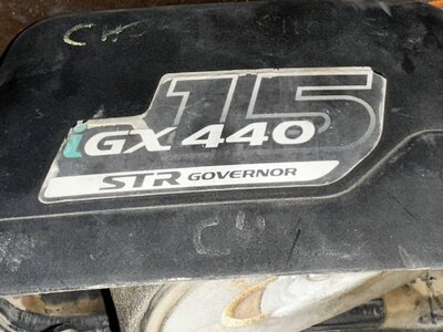

I also had to battle this igx440 in the past year. I gave up. There are no spare parts available, no piston kits. Mine doesn't run in cold, it has bad compression. Even in summer it is hard to get it started.
I will probably replace it with igx390, I just need to figure exactly which model i need. My igx440 is marked as QPAA, may I ask which variant do you have?
