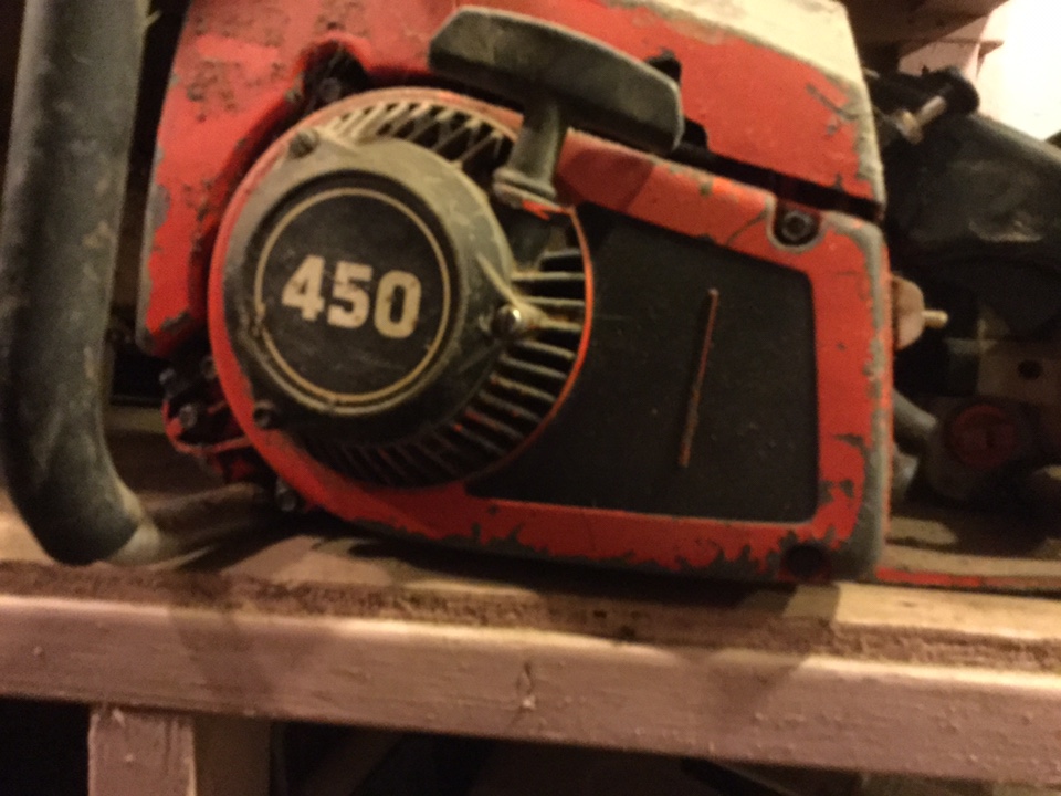

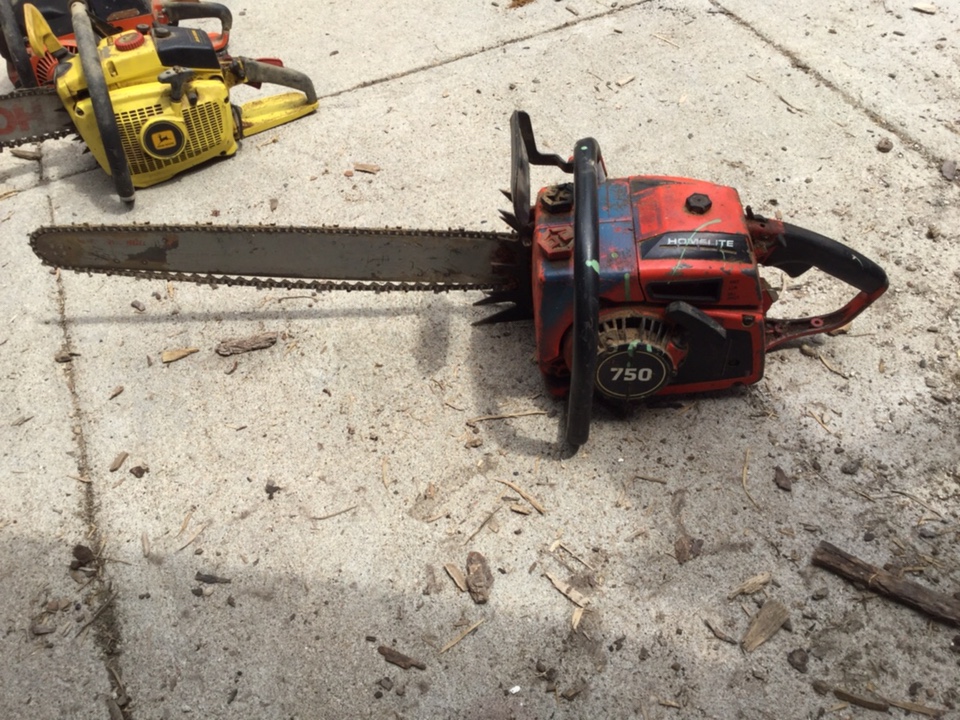

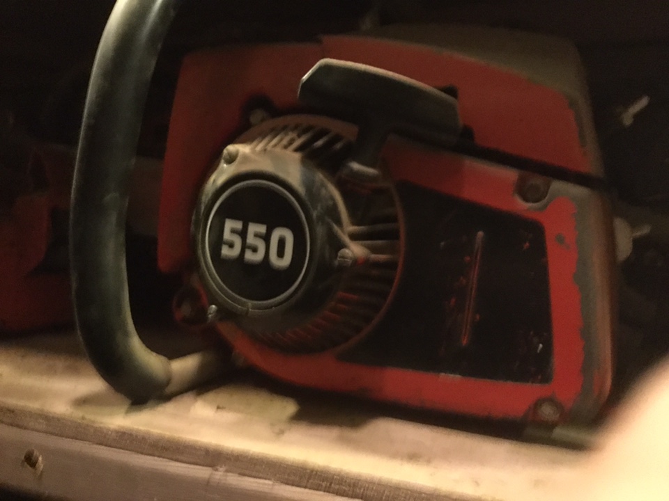

WIW the three in a package deal?
And, yes, that’s an Echo twin in the background. [emoji6]
