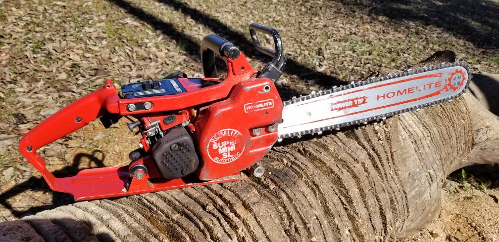

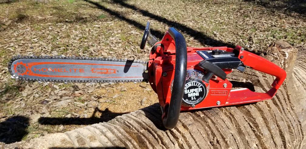

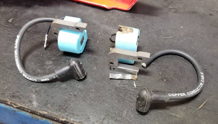

This Super Mini SL had a bad solid state coil. I didn't have the exact one so I took one of my new coils for a XL-12/SXL and swapped cores. The VI setup works very well limiting vibration.
