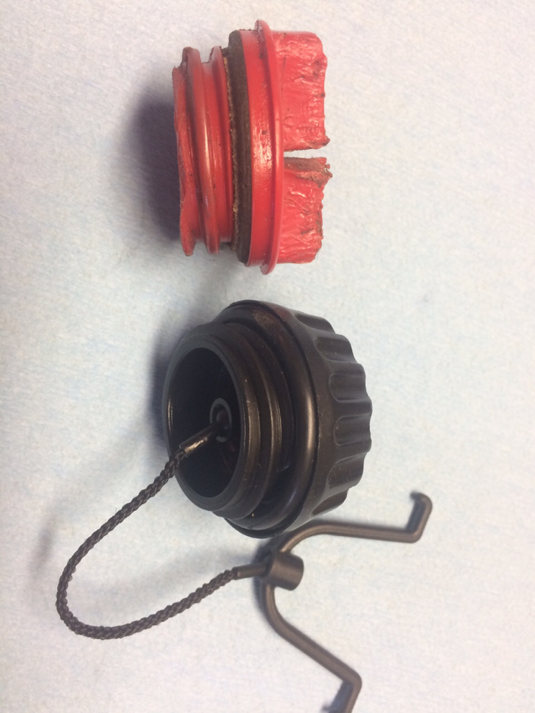

Does Stens have fuel and/or oil caps for 575 & 695?
Ereplacements and partstree were a bust.

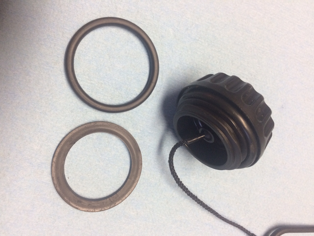

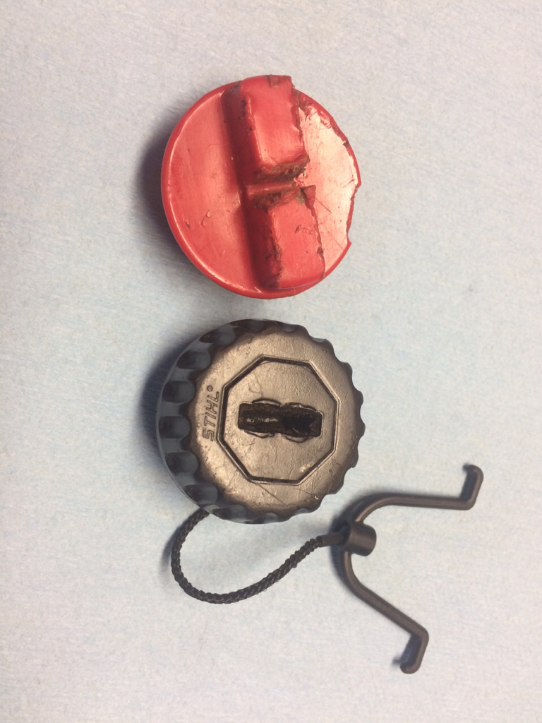

The oil cap is shared with the 575.
The fuel cap is shared with the 550, 575 and 680.
Hope this helps.
The Stihl 029 type fuel cap fits well.
Replace the Stihl washer with a suitable 'O' ring.
At least I'll have something in the hole while the original cap 'dries' and shrinks back down.

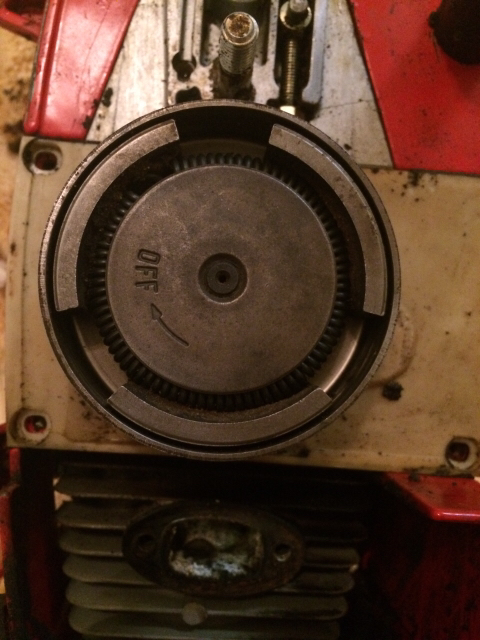

Does shindaiwa make a removal tool for this? It's on a 345
67L36Driver
3:02 PM
596
9,678
41,688
Make a three legged spanner wrench to catch the shoes.
Or, drill & tap two holes for 1/4"-20 (locate carefully!) in the clutch hub.
