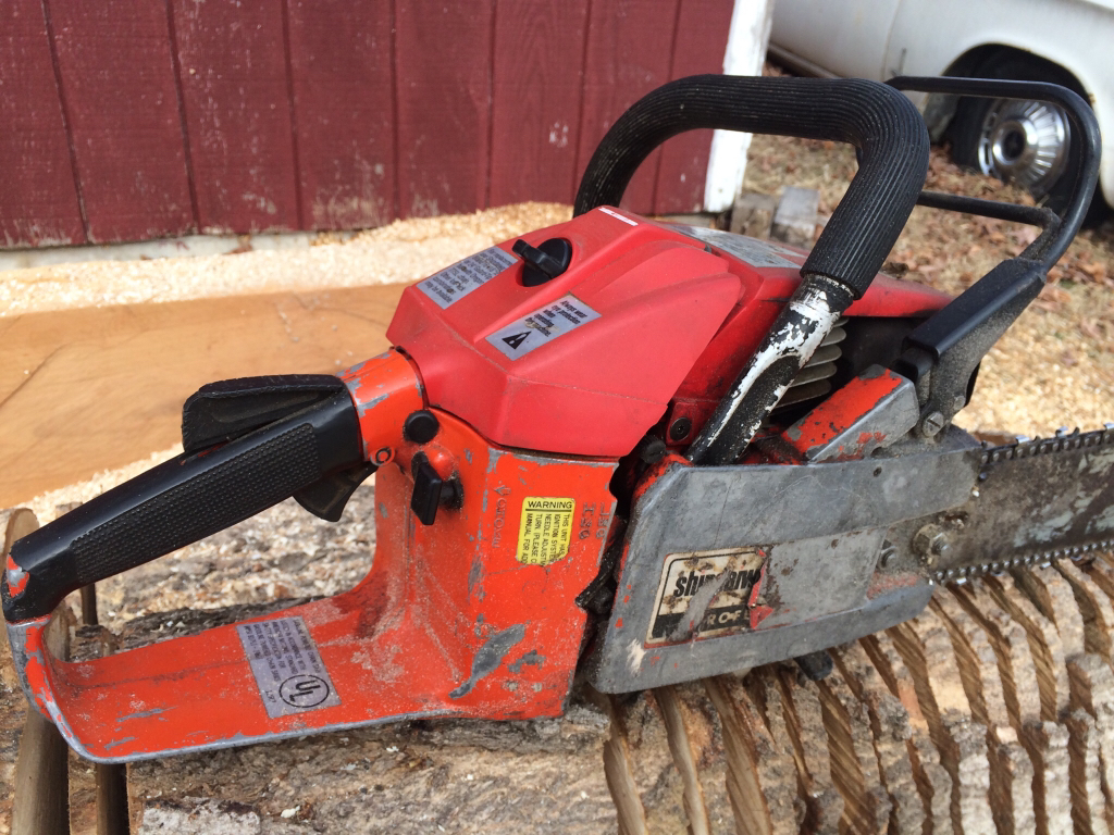

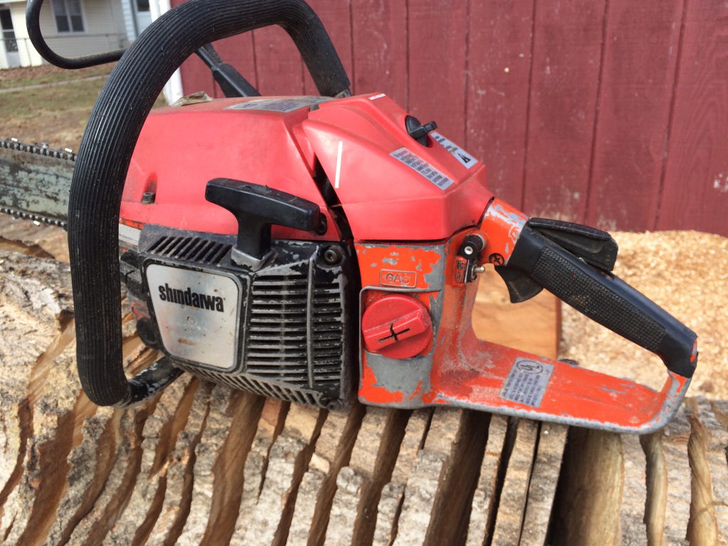

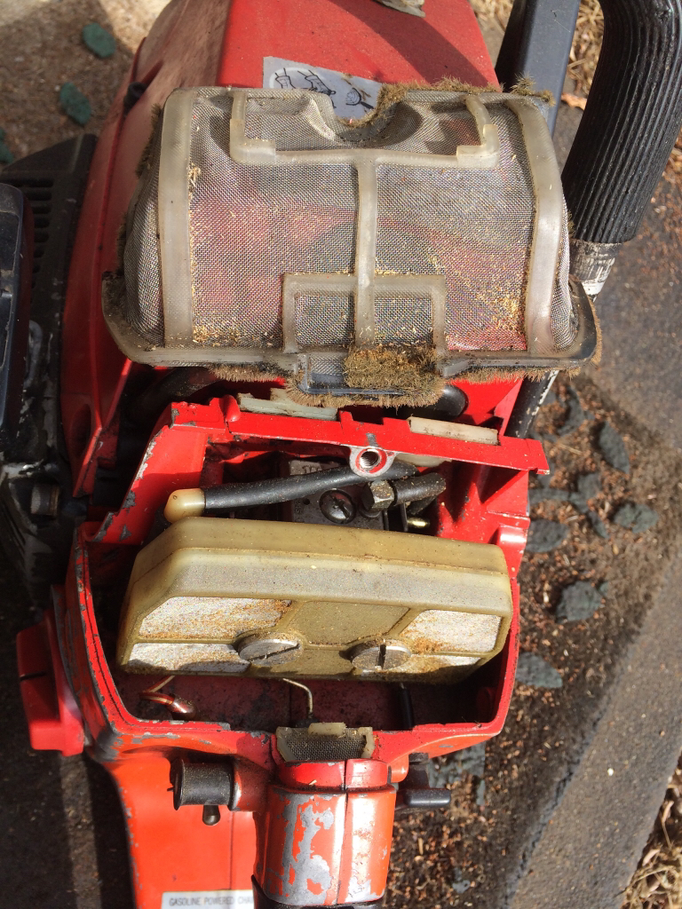

Shindaiwa 695(?). From a trade reciently. Willing runner he is.
At first I thought it needed an air filter.
But, I was wrong.[emoji15]

Mag tank. More likely 575 or 680. Despite the sticker describing the 695 USFS muffler. 575=45mm 680=49mm jug. Dibz,within reason.

I got it from Workshop who got it from Sawnami.
Runs and cuts like one would expect from a 60-70 cc saw.
Spied the sticker you referred to.
Lists it as a 695 on it.
Not going to disturb rusty muffler bolts to measure the bore.[emoji6]
Post a picture of the serial number...
Recoil sticker looks like it said 575.
695 had mag tank as well.
