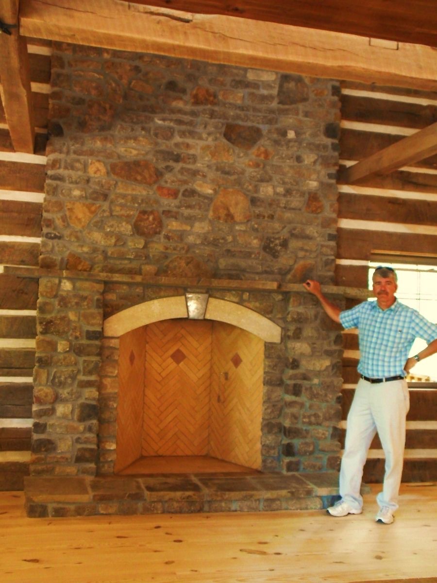

Search Out Soapstone Fireplace.
Before you turn away, they can be installed as an insert.
Most of my family are Buck Heater Insert fans, but Holland gets colder than Georgia, I Guarantee.
Added;
Uncle Ed has the Soapstone Heater.
My BIL has one. His house is open concept so the heat can radiate off the soap stone. The amount of soap stone was calculated for the living space and climate he lives in. He claims he burns two fires a day and the soap stone does the magic.
Probably a smart engineer came up with that idea.
