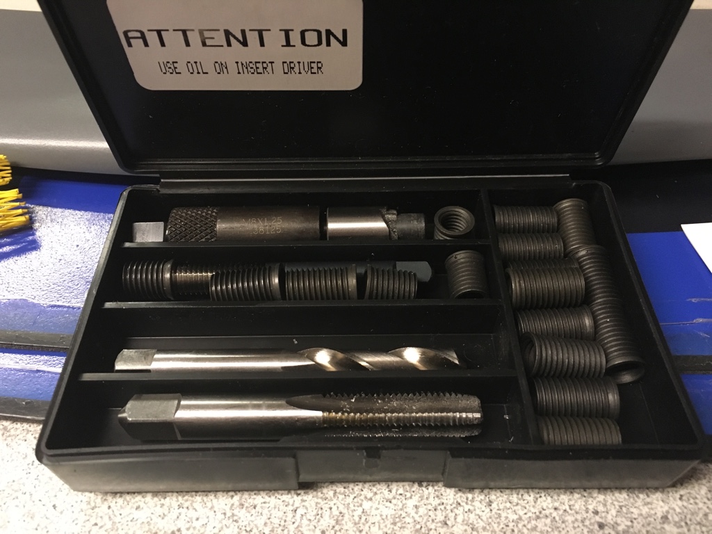

I think this one was about 35.00 and then i bought a pack of the smaller inserts for the saws but i dont remember the price of those.CAM00846.jpg
