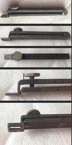

I have 1 of these. They cut to the chase for checking clearance. I like how it fits and feels. No second guessing.Note that this one is a single, ‘U’-shaped piece, which is different from the one in Post# 2 and #6.
More info in that thread, including instructions.
