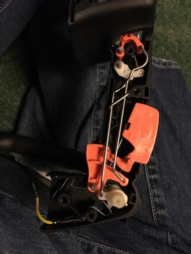

Here are the first pictures of the MS200T chainsaw puzzle. The rewind came apart during shipping but it was an easy fix. I'm working on the handle today, I must say it is more complicated then I thought it would be.
20200320_214224.jpg 20200316_204838.jpg 20200320_232901.jpg 20200320_232840.jpg

Yup, the handle guts are a real puzzle.

Yeh a real puzzle. But like most puzzles. Just glance over it.. start somewhere, and if you can’t see an answer, start somewhere else. Or leave it for another day.(get your head around it). which has worked for me many times
You could say a bit like matching peices up in a jigsaw puzzle.
that said, a starter recoil ( your pic) can be a royal pain. But if you tackle it the righteous way. It can have a good outcome..
